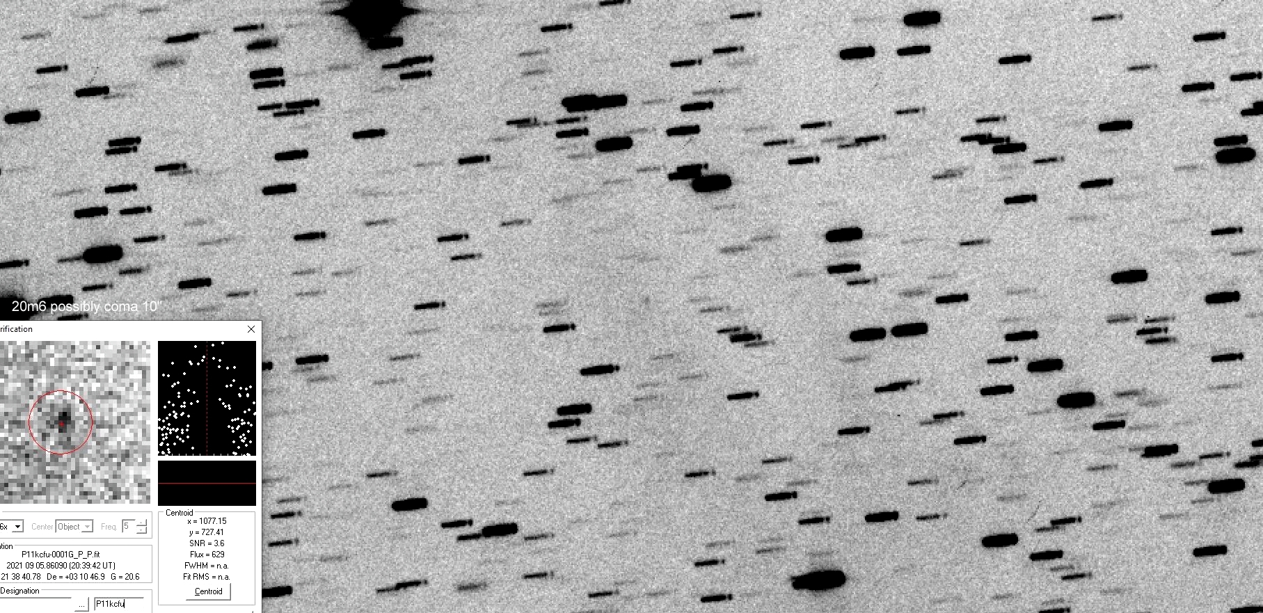

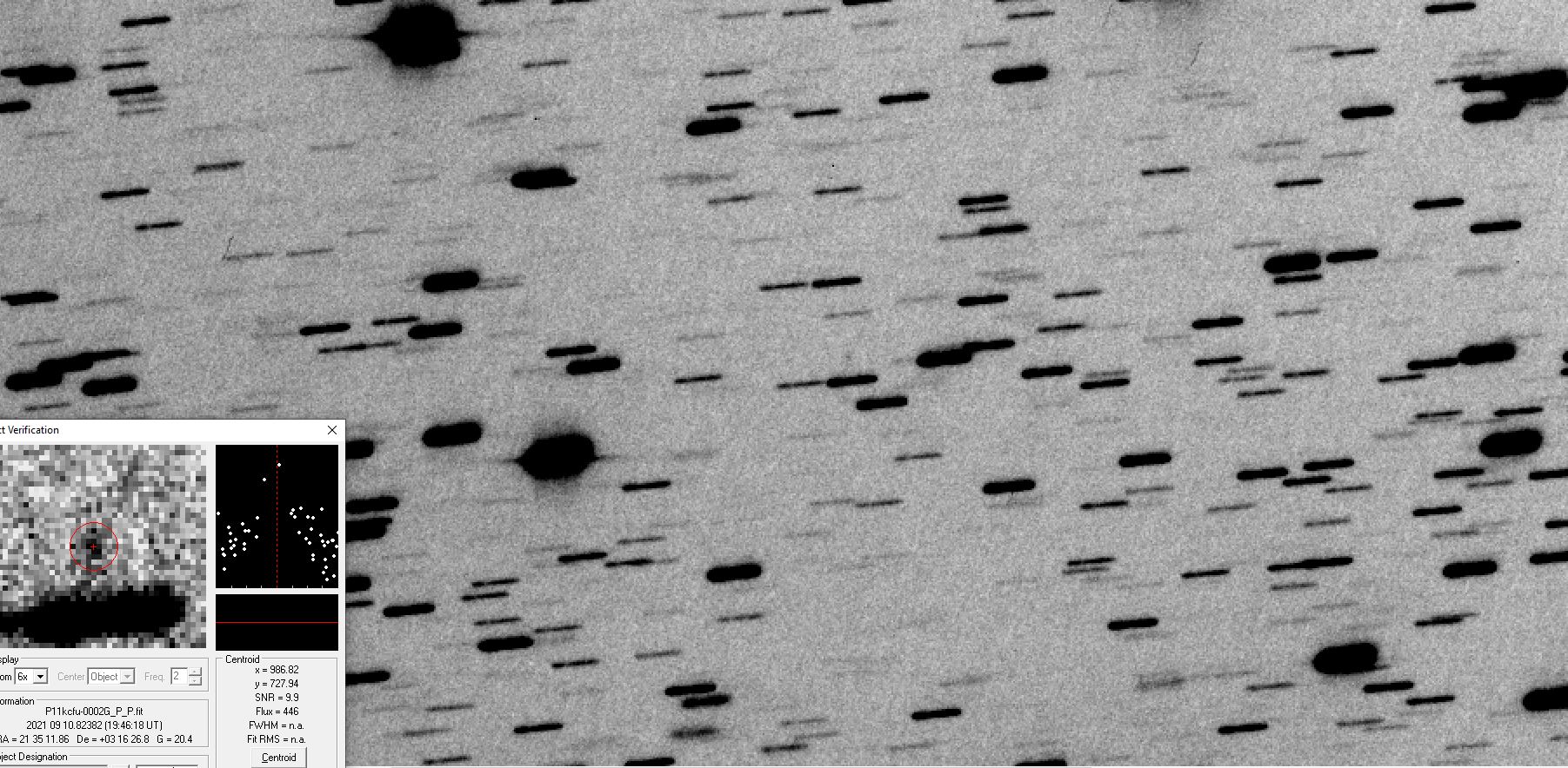

M. Jaeger reports cometary activity of an NEOCP candidate discovered by
Pan-STARRS 1 (F51) on Sep. 5 UT. In his follow-up observations taken later on
Sep. 5 at Stixendorf (A71) in sixteen 200-second images he notes a 10" coma.
Prediscovery positions were reported back to Jul. 2021. Additional reports of
cometary features are as follows:
A71 2021-09-10 M. Jaeger 9" 10x180s, 15x200s

Solche Objekte verlangen mit 12" zumindest 1 Stunde Belichtungszeit.
P11kcfu20210910ut1946sec10x180and15x200.JPG [ 345.03 KiB | 653 mal betrachtet ]
P11kcfu20210905ut2007sec16x200_2.jpg [ 969 KiB | 653 mal betrachtet ]

M. Jaeger posted on the ICQ Comet Observations Facebook page that sixteen
stacked 200-s exposures taken on Sept. 5.9 UT with a 0.30-m reflector at
Stixendorf, Austria, show a possible coma of size 10".
