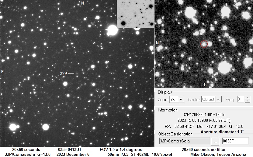

32P on 2023 December 6 was magnitude G=13.6 as calculated from 20x60 second images with no filter in a 1.7' diameter aperture.
32P_20231206_0353_molason.jpg [ 183.95 KiB | 3419 mal betrachtet ]
Cheers, Mike

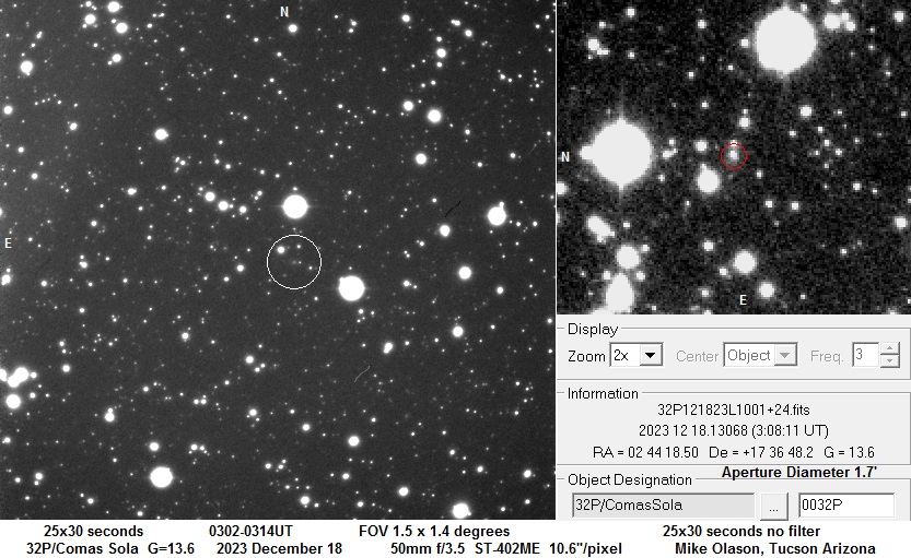

32P on 2023 December 18 was magnitude G=13.6 as calculated from 25x30 second images with no filter in a 1.7' diameter aperture.
32P_20231218_0302_molason.jpg [ 180.18 KiB | 3418 mal betrachtet ]
Cheers, Mike

13m6 in a small aperture: The comet comes close to what we need for visual observations. Thank you, Mike.
Terrible weather at the moment in Germany.

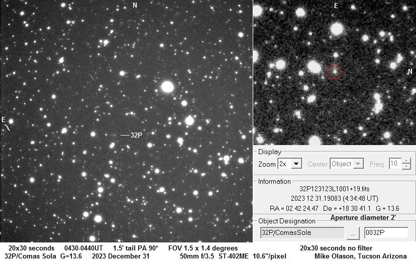

Wohnort: Tucson, Arizona
32P on 2023 December 31 was magnitude G=13.6 as calculated from 20x30 second images with no filter in a 2' diameter aperture. The comet has a 1.5' tail at PA 90 degrees.
32P_20231231_0430_molason.jpg [ 206.9 KiB | 3050 mal betrachtet ]
Cheers, Mike
:lol: Arizona

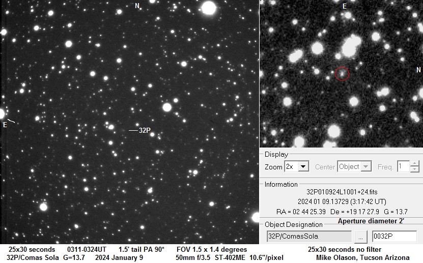

Beiträge: 439
32P on 2024 January 9 was magnitude G=13.7 as calculated from 25x30 second images with no filter in a 2' diameter aperture. The comet has a 1.5' tail at PA 90 degrees. The comet is currently at peak magnitude.
32P_20240109_0311_molason.jpg [ 173.42 KiB | 2739 mal betrachtet ]
Cheers, Mike
