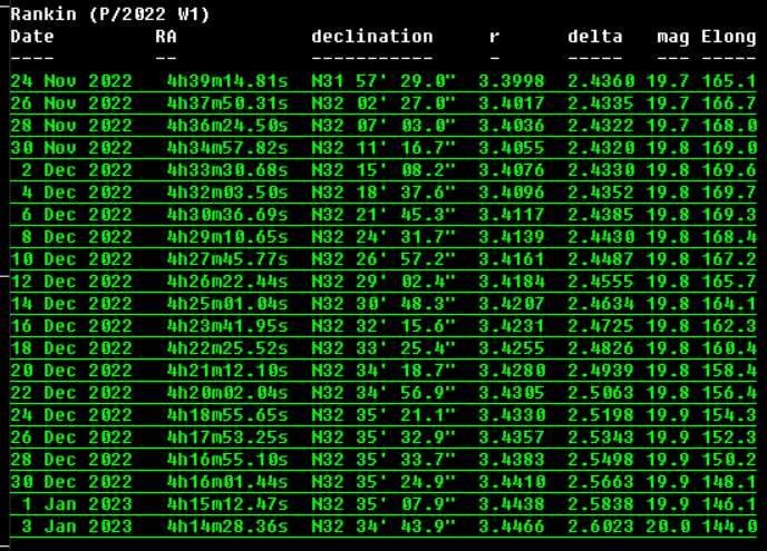

COMET P/2022 W1 = (Rankin)
Helligkeit ca. 19.5 mag, H = 12.5, 2.5n = 10,
P2022W1.png [ 91.01 KiB | 640 mal betrachtet ]
