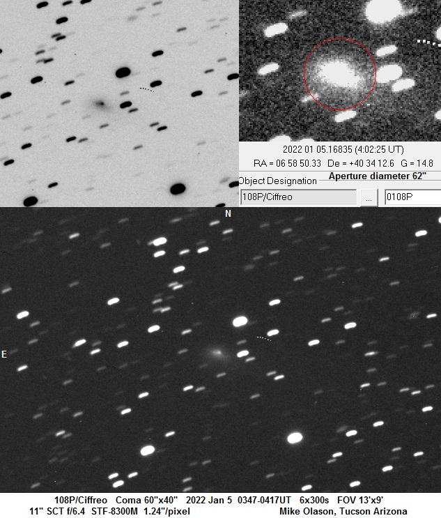

Hello Uwe, per your suggestion imaged 108P on 2022 January 5 (also have images from 2021 Dec 6 that I will have to process someday) and found a coma/tail complex that was 60"x40" with a bright central nucleus area. It appears the outburst ejected material at a PA of 90 degrees from the nucleus since that is the brighter area of the coma. Astrometrica calculate a magnitude of this entire area to be G=14.8 using 6x300s images with no filter. In the next few days I might make one of your favorite "dentist" limerick gif animations from the 12 300s images that I collected of 108P assuming they didn't rock and roll too badly.
108P_20220105_0347_molason.jpg [ 182.2 KiB | 7534 mal betrachtet ]
Cheers, Mike

Dear Mike, thank you for this. I always interest in comet physics. And your photgraphs are great: You show us real dim comets...
