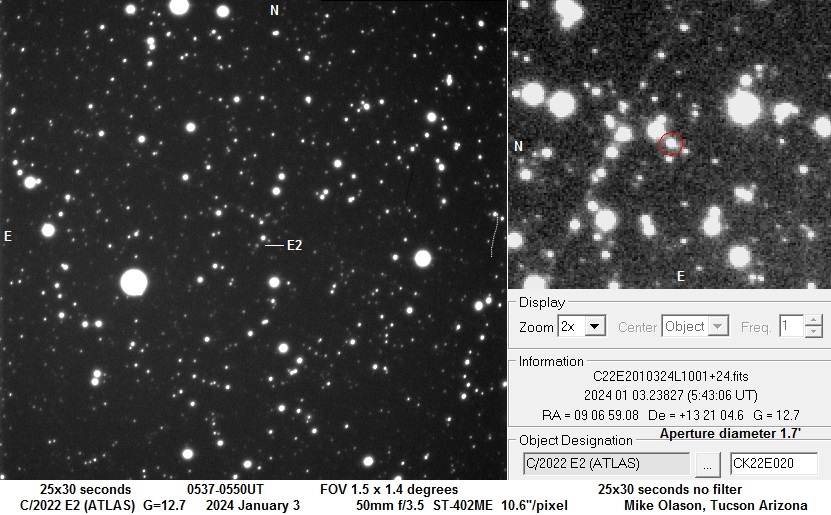

C/2022 E2 (ATLAS) on 2024 January 3 was magnitude G=12.7 as calculated from 25x30 second images with no filter in an aperture diameter of 1.7'. The comet is predicted to brighten to magnitude 11.5 in December 2024.
2022E2_20240103_0537_molason.jpg [ 169.4 KiB | 6523 mal betrachtet ]
Cheers, Mike
