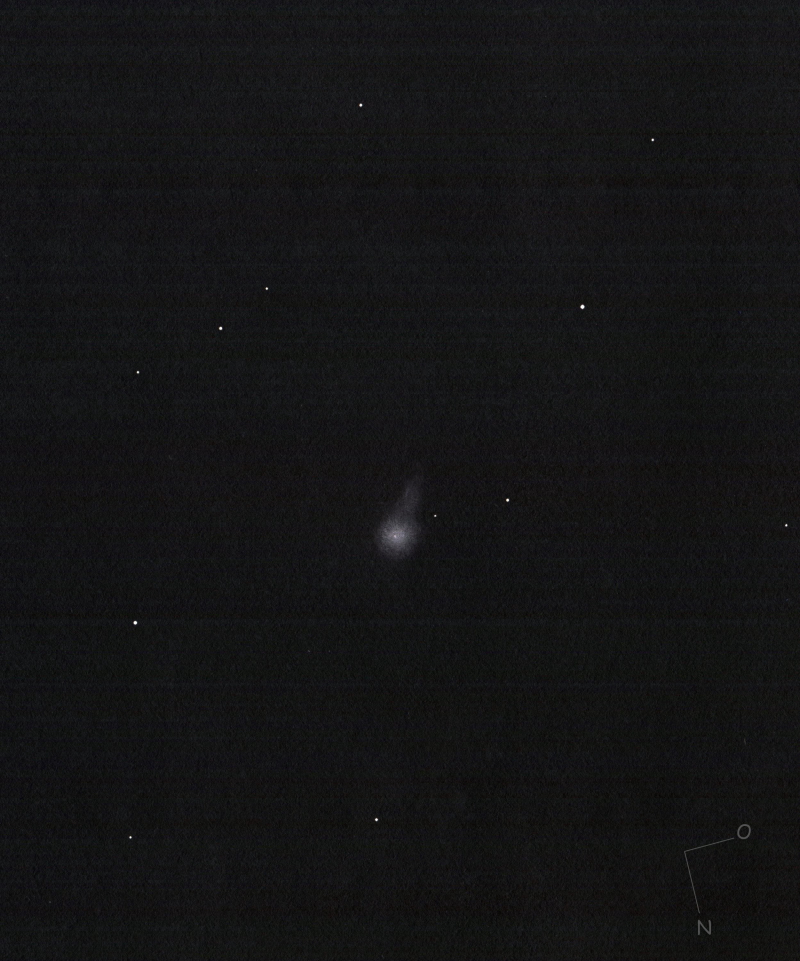

BeitragVerfasst: 04. November 2022, 00:26:14 AM
Wohnort: Zwischen HH und HB
hallo Forum,
V2 wird heller und zeigt nun auch visuell einen Schweifansatz.
1.11.2022, 22:52 MEZ, Region SQL 20.3mag, Mondschein (57% beleuchtet)
12" Dobson, V 132x
10.7mag, DC 4/5, Durchm 1.6` mit Schweifansatz 2`in PA 140°
Anbei eine Zeichnung :
20221101xC2020V2CN.jpg [ 527.96 KiB | 17937 mal betrachtet ]

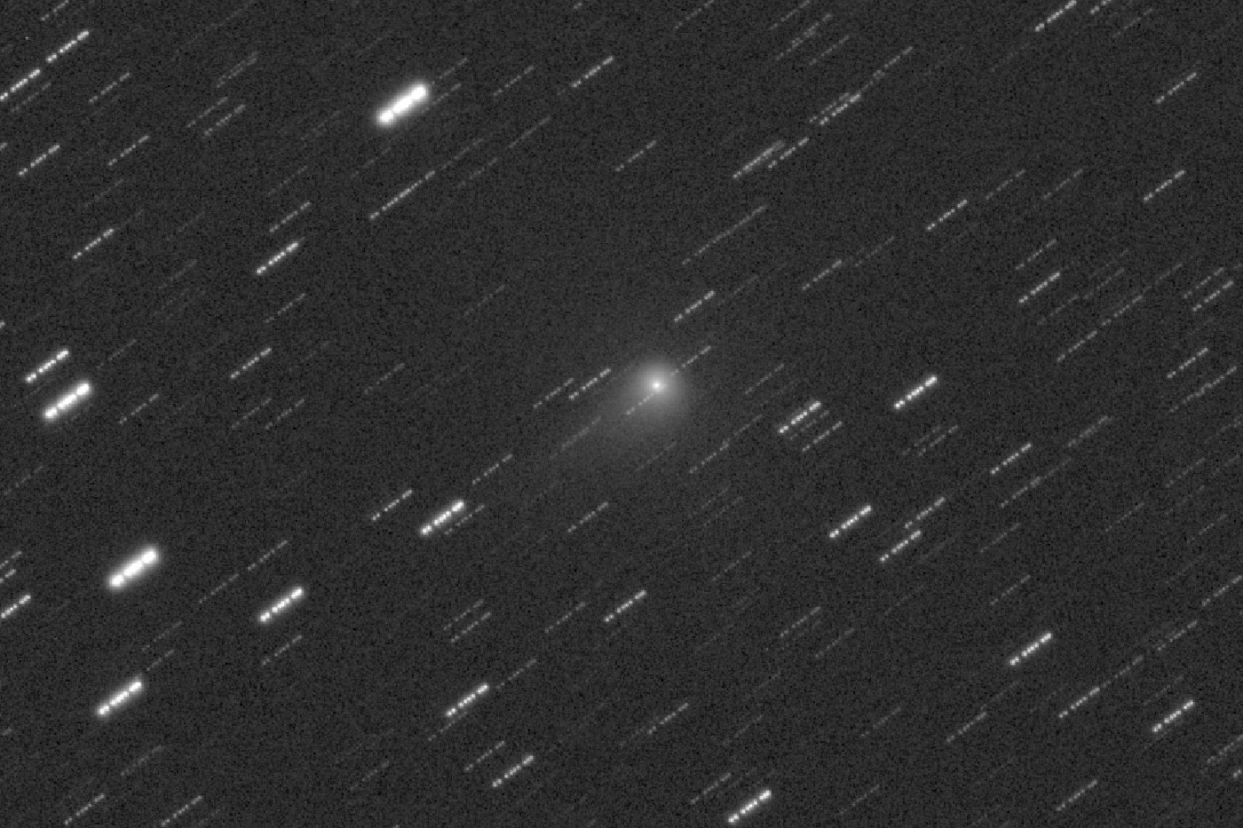

Der Komet entwickelt sich weiter erwartungsgemäß. Hier mein Ergebnis vom 18.12.2022.
C2020V2_2022_12_18_0240_0319UT_9x2min_ISO800_580mm_comet.jpg [ 357.71 KiB | 17493 mal betrachtet ]
2020V2.mag.221226.png [ 41.7 KiB | 17493 mal betrachtet ]

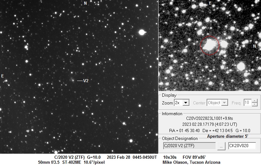

BeitragVerfasst: 09. März 2023, 09:16:04 AM
Beiträge: 439
Wohnort: Tucson, Arizona
Magnitude G=10.0.
2020V2_20230228_0445_molason.jpg [ 161.68 KiB | 16611 mal betrachtet ]
Cheers, Mike

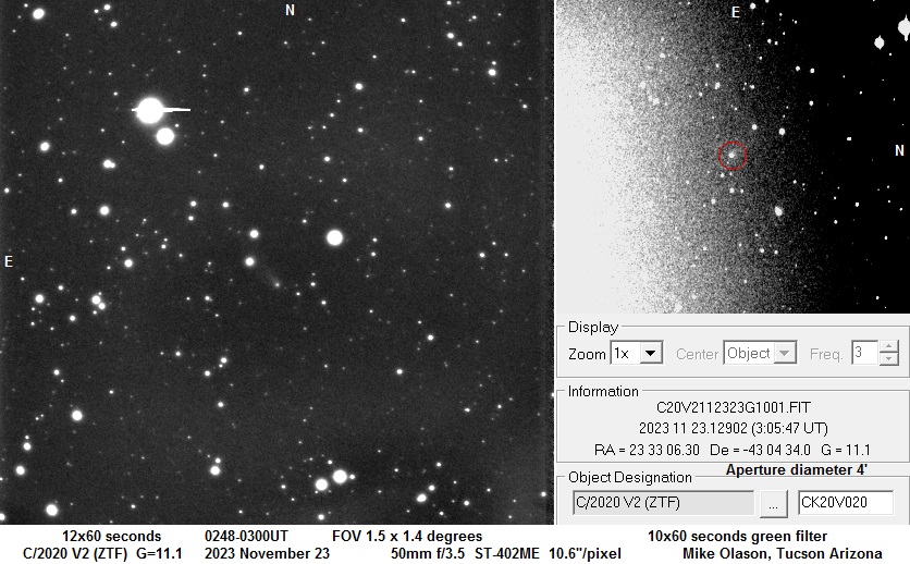

BeitragVerfasst: 26. November 2023, 19:38:48 PM
Beiträge: 439
C/2020 V2 (ZTF) under a moonlit sky on 2023 November 23 was magnitude G=11.1 at 0306UT as calculated from 10x60 second green filter images. The comet was low over the light polluted Tucson skies to the south so it is still an impressive comet, but after a year of magnitudes 9-10 it is now starting to fade as it moves out in its orbit.
2020V2_20231123_0248_molason.jpg [ 179.6 KiB | 15481 mal betrachtet ]
Cheers, Mike

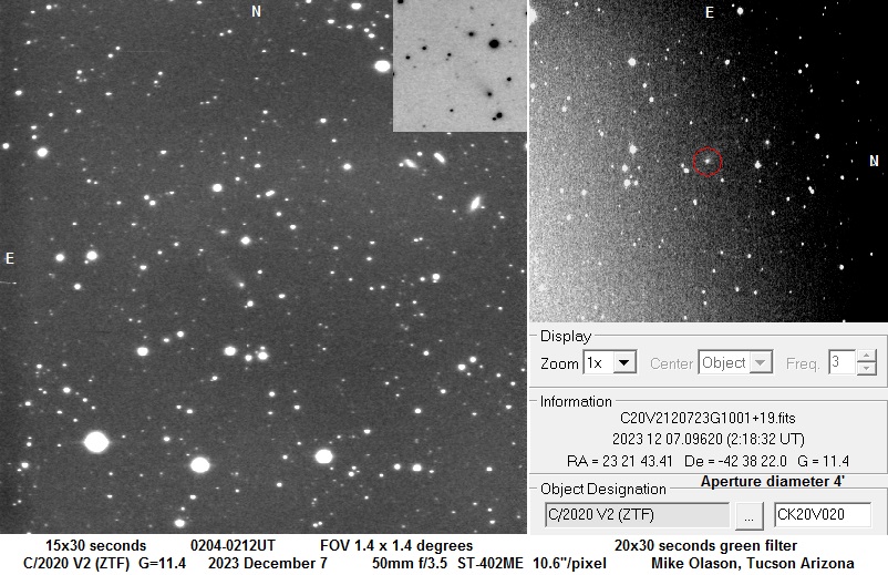

C/2020 V2 (ZTF) on 2023 December 7 low over the light polluted skies of Tucson. Calculations on 20x30 second green filter images showed the comet was magnitude G=11.4 in an aperture diameter of 4'. The comet still shows a nice tail even through all the light pollution.
2020V2_20231207_0204_molason.jpg [ 176.38 KiB | 13613 mal betrachtet ]
Cheers, Mike

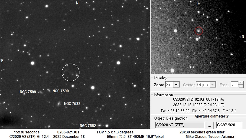

BeitragVerfasst: 22. Dezember 2023, 21:22:49 PM
Beiträge: 439
C/2020 V2 (ZTF) on 2023 December 18 low over the light polluted skies of Tucson. Calculations on 20x30 second green filter images showed the comet was magnitude G=12.4 in an aperture diameter of 2'. The comet still shows a nice 6' tail even through all the light pollution.
2020V2_20231218_0205_molason.jpg [ 153.9 KiB | 13268 mal betrachtet ]
Cheers, Mike

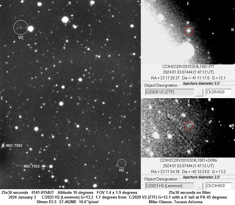

BeitragVerfasst: 05. Januar 2024, 03:18:19 AM
Beiträge: 439
Comets C/2020 V2 (ZTF) and C/2023 H2 (Lemmon) are now sharing the same part of the southern sky, only 1.7 degrees apart in these images. Unfortunately, they are low above the southern horizon, only 10 degrees above the light polluted Tucson skies as the sky starts to darken in the evening. C/2020 V2 is magnitude G=12.1 and C/2023 H2 is magnitude G=13.2 as calculated from 25x30 second images with no filter in an aperture diameter 2.5' wide. C/2020 V2 has a 6' tail at position angle 45 degrees from it's coma. The comets will be within 2 degrees of each other for the next week for those who want to make their nice portraits of the pair.
2020V2_20240103_0141_molason.jpg [ 244.25 KiB | 12922 mal betrachtet ]
Cheers, Mike
