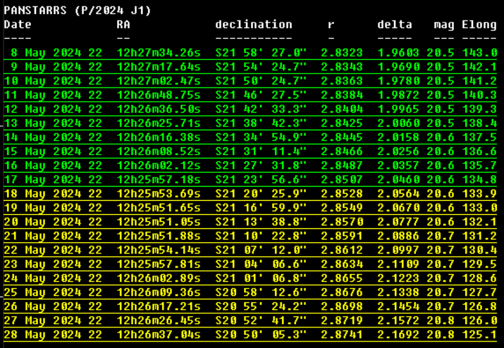

MPEC 2024-J133 :
R. Weryk reports the discovery of a comet in four 45-second w-band survey
images taken by Pan-STARRS 1 (F51) on May 1 UT, noting a diffuse 0".6 coma and
a straight 4" tail at position angle 45 deg. Prediscovery positions were
reported back to Mar. 2024.
https://minorplanetcenter.net/mpec/K24/K24JD3.html
Helligkeit ca. 20.5 mag, H = 14.5, 2.5n = 10
P2024J1.png [ 49.2 KiB | 1926 mal betrachtet ]
