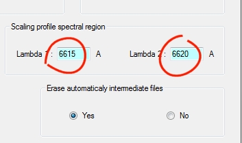

Hello all:
I have encountered some questions that I am not very clear about them. Hope to get your great advice & explanation.
<my ISIS is version 5.1.2>
1). Predefined mode. it has 1200L [6 lines], if this mode can ONLY be used to calibrate Ha zone?
2). For WR134, what should I fill in the "scaling profile spectral region " in the "Settings" Tab? I know that its fuction is to normalize the continuum by selecting a region where there is no spectra, no emission or absorption lines. Could you please explain deeply about it?
In addition, in "Profile" Tab there is a button "Normalize", too. what is the difference between them? How to use them correctly?
3). I know that I must redo new Instrument Response for Lhires3 after I change grating, slit,etc.. mechanical parts of it. I have read through the tutorial, but all exampls and contents are for Ha. And all data in the database and libraries in ISIS seem to be used for Ha. Then when we take spectra from other spectral ranges, i.e. 540nm, how to make the instrument response? What are the correct procedures?
Cheers,
Dong

1) The ISIS predefined modes only work in the Ha region.
2) If, with WR134, you are working around Ha then the 6615-6620A normalisation range is ok. If you are working at another wavelength you select a short region with a flat and low noise continuum (no obvious lines). The continuum in this selected zone is used as the 'unity' value for spectrum normalisation (scaling). You can rescale (re-normalise) at any time to a new wavelength reference by changing the "scaling profile spectral region " in the "Settings" tab and then clicking the "Normalize" button in the Profile tab ... or reprocessing the spectra with the new values.
3) If you are working in a different wavelength zone to Ha you will need to take a reference spectra using an argon, xenon or other light source. You then convert this spectra to a .dat format ("Spectra processing2' tab/ 'Extract a raw spectral profile') and then use the Profile/Dispersion tool to compute the polynomial values ... these are then used in the 'Predefined dispersion' or 'File mode' options of 'Spectral calibration' on the 'General' tab. Details of this process are given in the ISIS tutorials, but I accept that you have to search carefully to find them.
Cheers, Bernard
