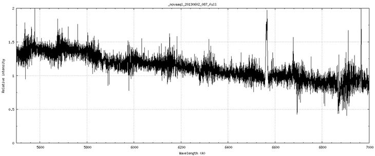

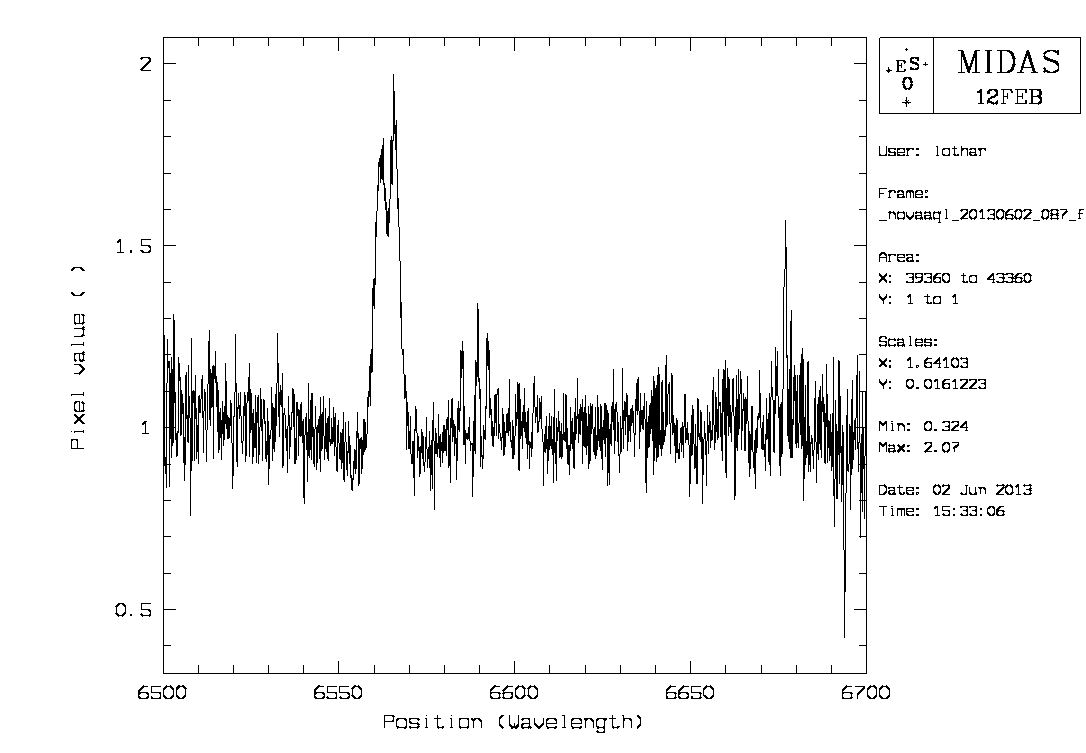

Hi all! Yesterday the following Nova Alert came from our french colleagues: http://tech.groups.yahoo.com/group/spec ... sage/14168
Knud Strandbeck and me (team 2 of the present Teide campaign) spontaneously stopped our ongoing WR programm and took a 600s echelle spectrum of this 11mag beast. Attached are the spectra independently quick-reduced by Martin Dubs and Lothar Schanne (ISIS and MIDAS, respectively). It seems that various emission lines in Halpha, He and Carbon are visible. The most prominent is Halpha with an 82km/s width. We now discuss with our Montreal PIs how to proceed. Next night we will take a 1800s spectrum and see what we can do.
Cheers, Thomas

Hi all,it seems not to be a nova spectrum. H alpha profile is typical of emission from a circumstellar disk, carbon lines may came from a hot component. Not a classical nova but something like a cataclysmic variable, dwarf nova. Also photometric surperhump were detected on VSNET.
This spectra is the first i've seen from the PN and for this is important to produce quickly. You may send it to ATel or VSNET.
Thierry

Yes, it is a dwarf nova.

It seems to be a dwarf nova in eruption as a nova, something they do every 10^{4-5} years. Both fall in the class of cataclysmic variable, i.e. low-mass accreting close binary with a WD and a low-mass companion as donor star. I?m asking my colleague Mike Shara what he thinks about continuing to observe this star.
Tony

Very well, Tony, at least Mike as an expert can give some advice. I hesitate to disturb our campaign but we should think about it as a potentially valuable target. If Mike says no, then we continue as it is.
Cheers, Thomas

Hello Thomas,
looking a bit closer at the spectrum, reanalyzing it with a more recent response curve and comparing it with a spectrum of the sky background taken a few days earlier I come to the conclusion that the lines around 6600 and at 6678 are due to the sky background, as well as the strong lines further towards the infrared. I attach a very rough spectrum of the sky background. The waves in this spectrum arise because it is quite difficult to correct the blaze function with almost zero intensity, but it shows where the orders are merged (increase of noise).
I think it would be advisable to record a background spectrum with the next spectrum of the suspected dwarf nova, if there is sufficient time.
Regards, Martin

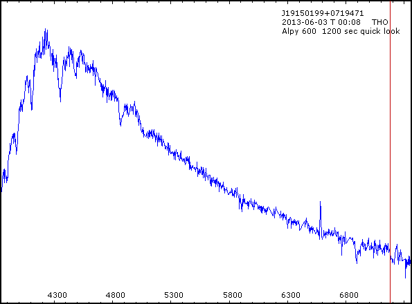

 Betreff des Beitrags: Nova Alert - PNV J19150199+0719471
BeitragVerfasst: 03. Juni 2013, 02:55:48 AM
(I am on it currently using my new Alpy low resolution spectrograph)
Here is a quick plot of the first 20min exposure from tonight
BeitragVerfasst: 03. Juni 2013, 03:06:43 AM
Note this was at ~30deg elevation and is uncorrected for extinction so the drop at the blue end will be exagerated

BeitragVerfasst: 03. Juni 2013, 03:06:53 AM
Nice stuff and in good agreement with our observations. We just finished a one hour exposure (lost 15 additional minutes due to read-out trouble). Now we do a 30 minutes sky background exposure. Hopefully, Martin and/or Lothar have reduced it tommorrow. Unfortunately, it is a bit faint and we need such a long exposure time. And, of course, we want to continue our initial program.
