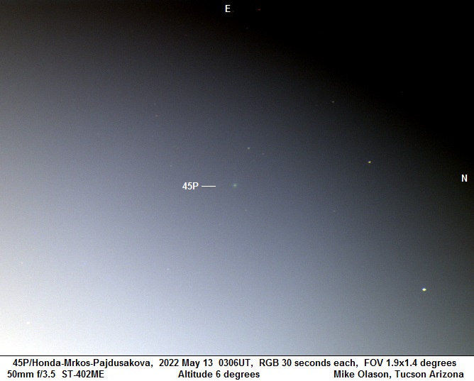

Comet 45P/Honda-Mrkos-Pajdusakova was imaged on the evening of 2022 May 13 UT. The comet was 19' at PA 258 degrees from the MPC predicted position and 3' at PA 258 degrees from the JPL predicted ephemeris position. The comet showed very well in a green filter and it looked green in the color image. Using the green filter data Astrometrica calculated the magnitude at V=6.8 in an aperture diameter of 5'. The comet is still in twilight as can be seen in the color image.

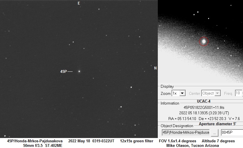

Comet 45P/Honda-Mrkos-Pajdusakova images from the evening of 2022 May 18 UT. Using 12x15 second images taken with a green filter Astrometrica calculated magnitudes of V=7.5, 7.4, 7.6 at 0305, 0310, 0321UT respectively. From the 12x15s image with no filter the measured coma is 2' wide with a tail 30' long at a position angle of 87 degrees from the coma. The color image continues to show a very green comet. The comet is located 13' at position angle 261 degrees from the latest MPC ephemeris update.
