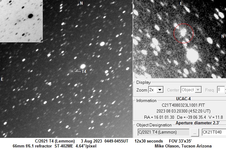

This was not what I expected to see when I imaged C/2021 T4 (Lemmon) which was reported to be approximately magnitude 8. Maybe the fact that it was only 11 degrees above the light pollution of Tucson under hazy desert skies illuminated by a nearly full Moon made for poor images, but I was not expecting Astrometrica to generate a magnitude of V=11.8 in an aperture diameter of 2.3' which appeared to amply cover the coma. An aperture diameter of 5' generated a magnitude of V=10.9.

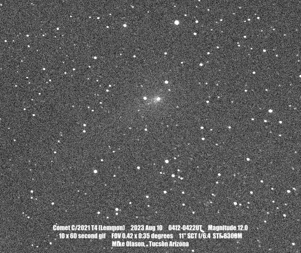

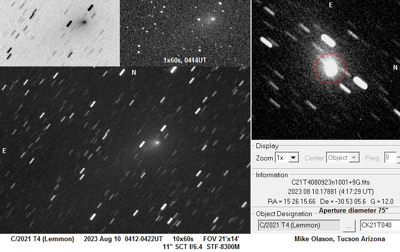

Managed to grab these images of C/2021 T4 just before a thunderhead soaked me as I pulled the plug and covered the equipment, Summer in the desert. The images were collected using an 11" SCT vs a 66mm refractor last week but still did not show a very impressive comet, G=12.0, with no Moon in the sky this week, although the images were collected above the horizon over a very light polluted Tucson.
