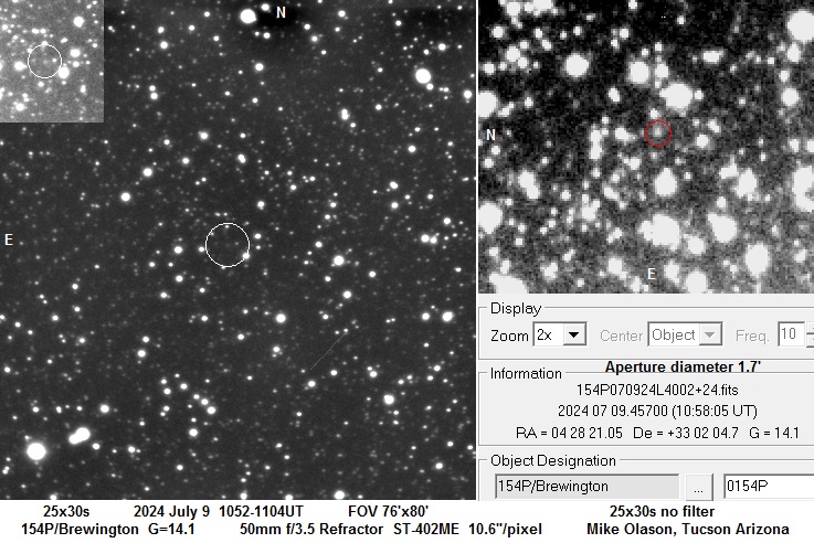

Comet 154P/Brewington on the morning of 2024 July 9 was magnitude G=14.1 as calculated from 25x30s images taken with no filter in an aperture diameter of 1.7'.
154P_20240709_1052_molason.jpg [ 166.27 KiB | 25526 mal betrachtet ]
Cheers, Mike

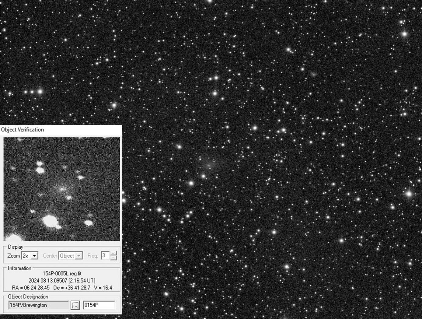

anbei ein 154P Bild von heute morgen, Astrometrica bestimmt lumpige 16m4, während die Helden vom MPC weiterhin 11m1 melden, mit langem Schweif .....
154P_Guide.JPG [ 19.05 KiB | 23243 mal betrachtet ]
154P_20240813_0213_5B_2min_MG_L_R_b2.jpg [ 463.03 KiB | 23243 mal betrachtet ]

Tach Roland,
die Helligkeitsparameter von alten Kometen werden vom MPC so gut wie nie aktualisiert. Die noch immer angezeigten Werte für Ho und n stammen vermutlich noch aus dem Entdeckungsjahr 19hundertschießmichtot. Ich empfehle Dir mal eine andere Quelle, nämlich das Jet Propulsion Laboratory JPL https://ssd.jpl.nasa.gov/tools/sbdb_lookup.html#/
Hier folgt eine mit den Default-Elementen für 154P gerechnete Ephemeride Juli bis September - Deine Helligkeit paßt bestens!!!

 Betreff des Beitrags: Re: Comet 154P/Brewington
BeitragVerfasst: 13. August 2024, 22:53:57 PM
Beiträge: 439
Wohnort: Tucson, Arizona
Roland, now I know why I could not find 154P a couple mornings ago with the 50mm f/3.5 setup which can only find comets down to about magnitude 16 on a perfectly clear night. What is interesting about this comet is that during its time around perihelion, magnitude reports ranged from magnitude 10 to 17 which makes one wonder if this comet was having some temporary outbursts that quickly dissipated or if reports were made on stars instead of the comet in this very crowded star field. The nice thing about software like Astrometrica, it takes the human element out of the equation once one figures out the correct parameters for the equipment setup being used. Seiichi Yoshida's curves suggest the comet should be about magnitude 13-14 right now, but from what I have observed the comet has been several magnitudes fainter than predicted during this orbit into the inner solar system. It looks like Michael's JPL data is predicting the magnitude fairly accurately right now compared to the MPC.
Cheers, Mike
:lol: Arizona
BeitragVerfasst: 13. August 2024, 23:52:29 PM
Beiträge: 439
I should clarify my last post. When Uwe, Otto and some others make visual magnitude estimates of comets I find those estimates to be very reliable and they always fit into the statistical mean curve of what both visual and electronic estimates are observing when taking into consideration an accepted coma size. But statistically when an estimate is well outside the mean, either the comet has had an unexpected event which will be verified by other observations, or the estimate simply can't be taken seriously and should be rejected from the data.
Cheers, Mike
