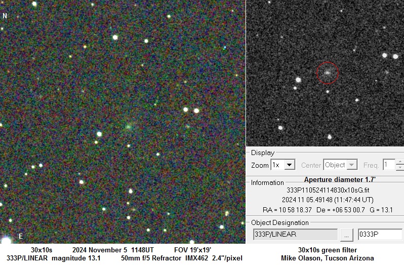

333P/LINEAR which may become brighter than magnitude 10 in early December was magnitude G=13.1 as calculated from 30x10 second images taken thru a green filter in an aperture diameter of 1.7' on the morning of 2024 November 5 UT.

Cheers, Mike
