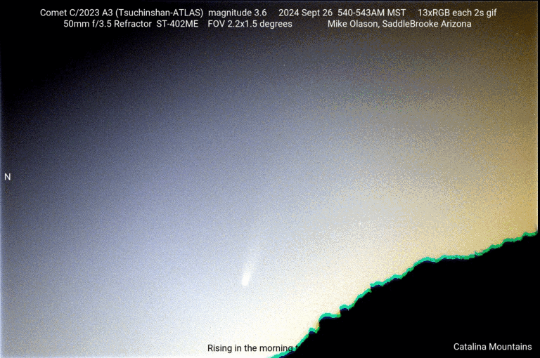

C/2023 A3 on the morning of 2024 September 26 UT was magnitude G=3.6 as calculated from 9x2 second images in an aperture diameter of 5'. The comet was at an altitude of 8.2 degrees rising above the Catalina Mountains and the Sun was 8 degrees below the horizon at 1240UT. The image shows the white comet on the right and then an attempt to show the comets true color on the left. The 13 image gif (RGB each 2s) shows the comet rising at 1240UT until 2 second images could no longer be taken due to saturation at 1243UT.
2023A3_20240926_1240_molason.jpg [ 176.08 KiB | 73299 mal betrachtet ]

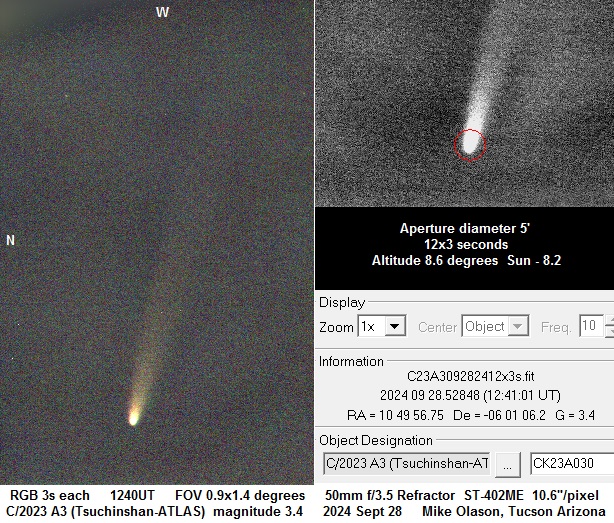

Beiträge: 439
Wohnort: Tucson, Arizona
C/2023 A3 on the morning of 2024 September 28 UT was magnitude G=3.4 as calculated from 12x3 second images in an aperture diameter of 5' with the comet now moving away from the Sun and getting a little closer to Earth. The software has calculated that the comet has brightened 0.1 magnitudes each day for the last several days since calculations have been possible with my observations, the calculated magnitudes are not as bright as others have estimated but we all agree the comet continues to brighten. What may be surprising is that no outbursts have been observed in the last few weeks since the comet came back into view for Earthlings. One would think the comet would not disintegrate without some prior outbursts. Sadly, another animation of the comet rising over the Catalina mountains which take away those precious 8 degrees to the horizon when the Sun is much lower and the sky much darker, flat North Dakota does have some benefits, maybe.
2023A3_20240928_1235_molason.gif [ 2.36 MiB | 72760 mal betrachtet ]
2023A3_20240928_1241_molason.jpg [ 194.2 KiB | 72760 mal betrachtet ]
Cheers, Mike

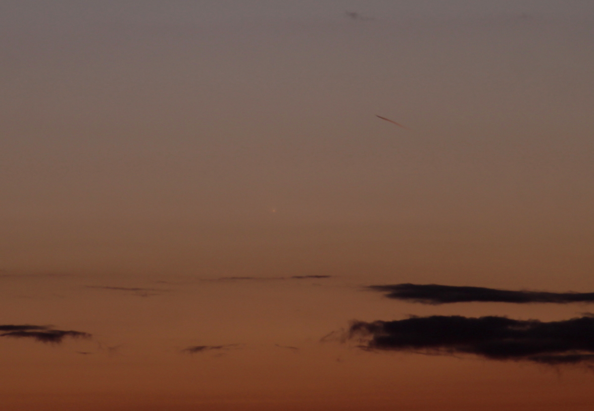

zweiter Versuch heute von Stuttgart aus am Rand des Kessels mit Blick über die Stadt. Der Himmel war klar, in Horizontnähe etwas Dunst. Mit dem Fernglas habe ich ihn nicht gesehen, aber die Aufnahmen zeigen den Kometen etwas überraschend dann doch. Nikon Z6II mit Canon 200 mm f/2.8, ISO 1000. Fünf Aufnahmen von 6:27 bis 6:32 Uhr MESZ mit 1/5 s bis 1/2 s gemittelt. Um 6:30 Uhr: Sonne -9°, Komet +3,2°. Das zweite Bild ist ein Ausschnitt des ersten. Insgesamt doich ernüchternd, auch wenn ich nicht viel erwartet hatte.
VG
Sven

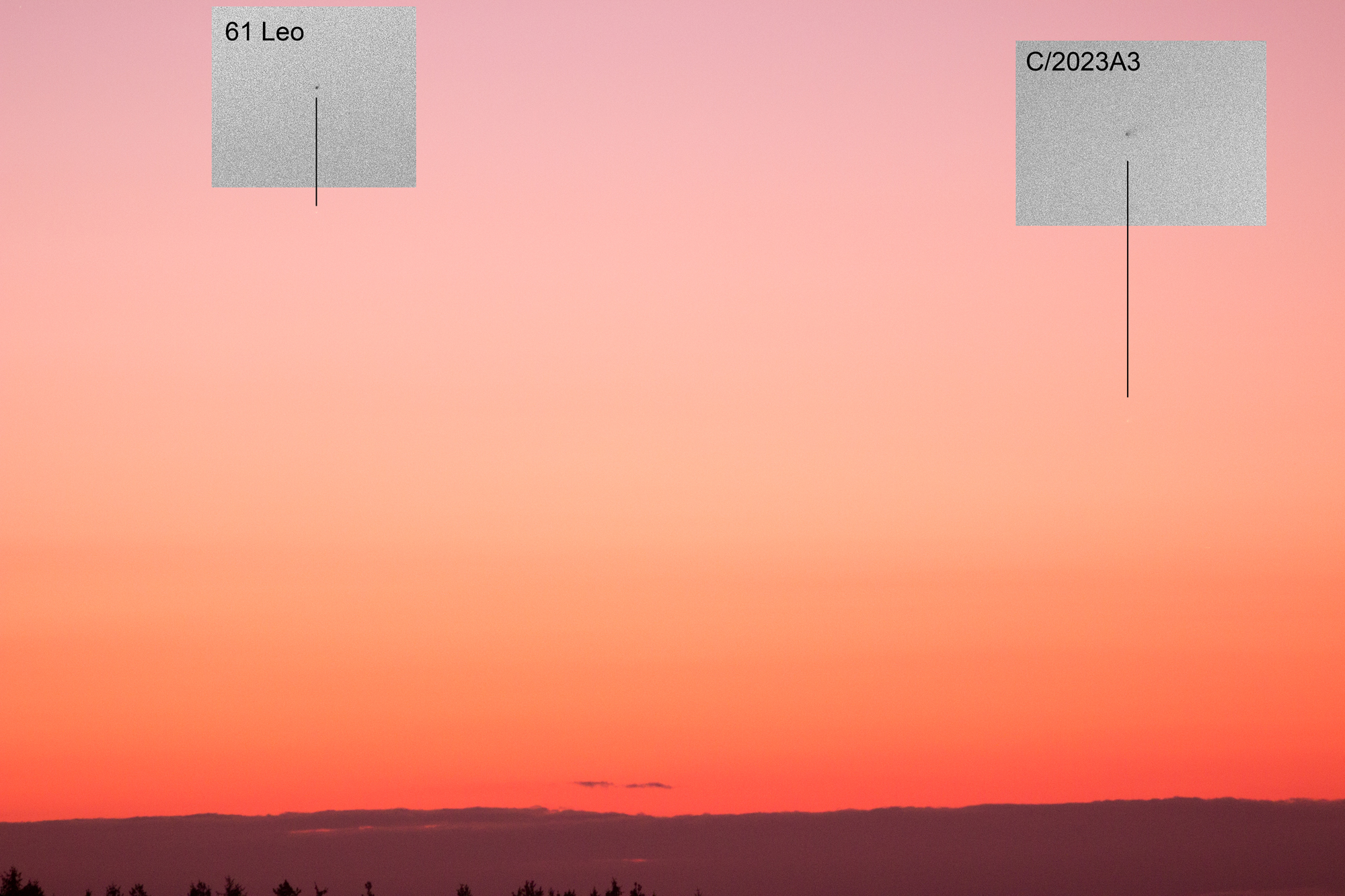

fotografisch hatte ich doch Erfolg! Das Foto ist nicht schön, reicht aber zur Dokumentation.
Aufgenommen um 06:24 MESZ, also 34h37m nach dem Perihel des Kometen (2024-09-27.74082 laut Website von Seiichi Yoshida). Der Komet befand sich 2°17' über dem theoretischen Horizont, Elongation 22.6°, Sonne 10.3° unter dem theoretischen Horizont.
Ein kurzer Schweif zeigt nach oben rechts.
Aufnahmedaten:
Canon EOS 600Da, Canon EF 200 mm f/2.8 L (==>) f/2.8 L II, ISO 1600, 0.4 Sekunden Belichtungszeit
Auf dem Bild konnte ich außerdem noch den 4.7 mag Stern 61 Leonis erkennen. Über dem Stern und über dem Komet befinden sich Ausschnittsvergrößerungen, jeweils um 2x vergrößert dargestellt, monochrom invertiert und gestreckt. Dies zeigt, dass zwar der Stern nicht ganz rund abgebildet ist, aber dass der Komet definitiv anders aussieht mit einem kurzen Schweif. Also im Wesentlichen dass es sich nicht um einen Stern handelt.
Clear skies

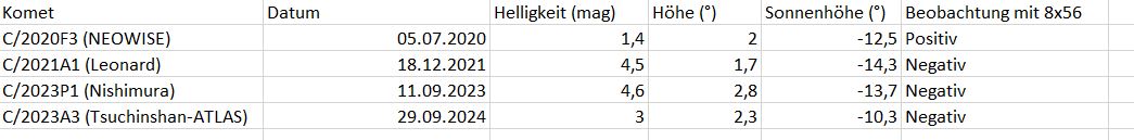

ich habe versucht, meine heutige Nicht-Beobachtung durch einen Vergleich mit früheren Kometenbeobachtungen von mir einzuordnen, bei denen der jeweilige Komet weniger als 3° über dem theoretischen Horizont stand. Siehe Anhang. Selbstverständlich spielen auch die Wetterbedingungen (Dunst am Horizont etc.) eine Rolle.
C/2020F3 (NEOWISE) war bisher der einzige Komet, bei dem mir das visuell mit einem 8x56 Feldstecher gelungen ist. Er war zu dem Zeitpunkt 1.6 mag heller als C/2023A3 heute. Und bei meiner heutigen Beobachtung stand die Sonne näher am/unter dem Horizont.
Vielleicht wird es ja in zwei Wochen mit der Vorwärtsstreuung. Hoffen wir auf gutes Wetter. :-)
Mike, excellent images! The shape of this comet reminds me of C/2020F3 (NEOWISE) right after perihelion. You are lucky in Arizona with the comet being more than 8° above the horizon when imaging it. Were you able to observe it visually?
Clear skies

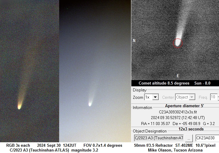

BeitragVerfasst: 30. September 2024, 18:55:56 PM
Beiträge: 439
C/2023 A3 on the morning of 2024 September 30 was magnitude G=3.2 as calculated from 12x3 second images in an aperture diameter of 5', a little fainter than yesterday when it was magnitude G=3.0. The comets tail is now showing a dark lane in the middle of the tail close to the coma.
2023A3_20240930_1242_molason.jpg [ 199 KiB | 72073 mal betrachtet ]
2023A3_20240930_1241_molason.jpg [ 138.6 KiB | 72073 mal betrachtet ]
Cheers, Mike
:lol: Arizona

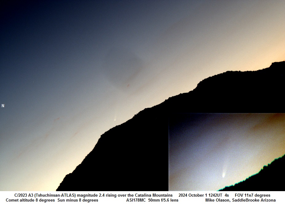

BeitragVerfasst: 01. Oktober 2024, 21:12:29 PM
Beiträge: 439
C/2023 A3 on the morning of 2024 October 1 UT was magnitude G=2.4 as calculated from 8x2 second images taken thru a red filter in an aperture diameter of 5'. Looking at yesterday's magnitude calculation it became clear that the images used for the calculation were near saturation and did not generate enough stars for Astrometrica to properly calculate the comets magnitude. By using images a few minutes after the comet rose above the mountains Astrometrica had more good stars to calculate a magnitude G=2.8 for the comet on 2024 September 30. It is now time to go farming in North Dakota, clear skies.
2023A3_20241001_1241_molason.jpg [ 263.17 KiB | 71889 mal betrachtet ]
2023A3_20241001_1242_molason.jpg [ 150.31 KiB | 71889 mal betrachtet ]
Cheers, Mike
:lol: Arizona

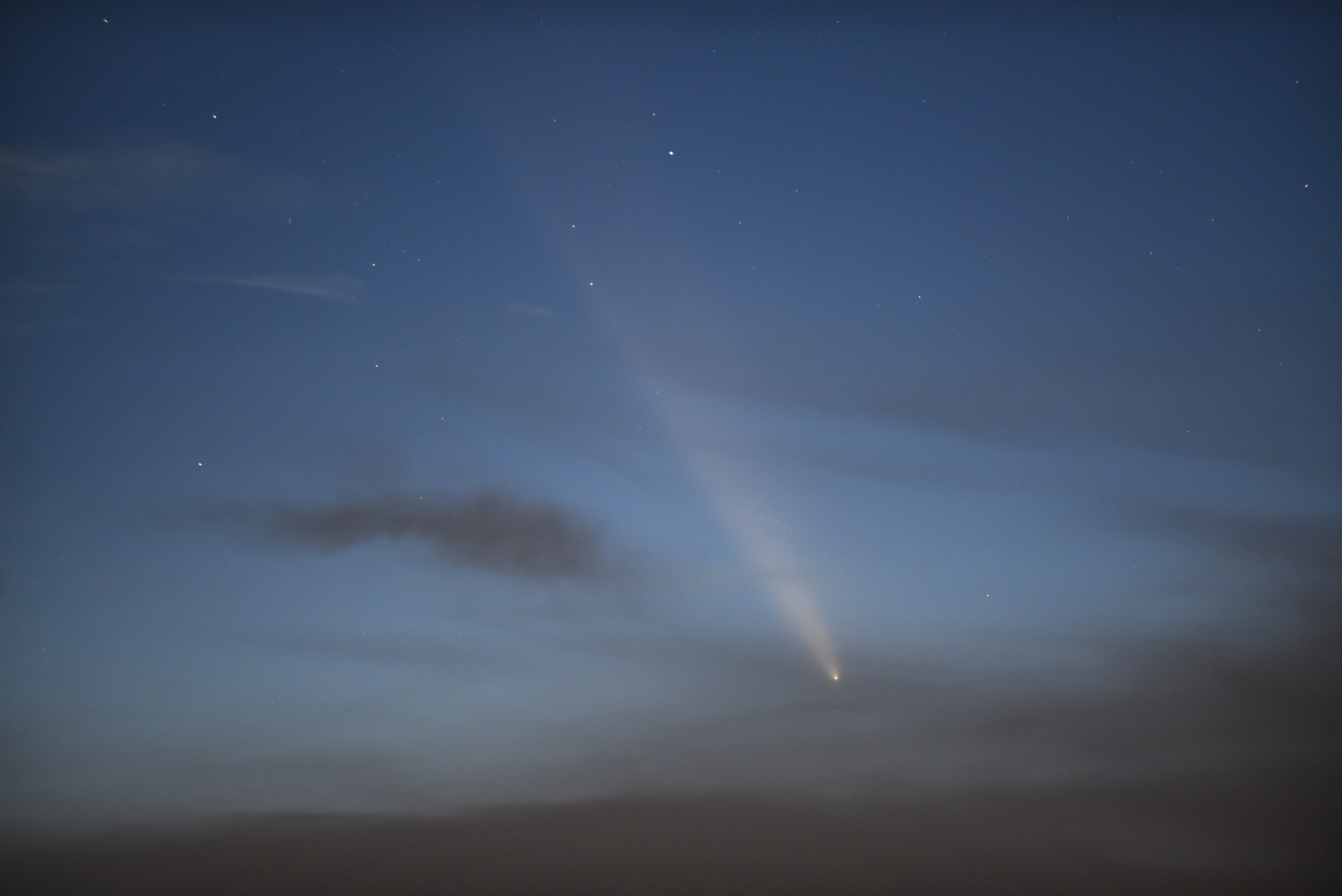

C/2023 A3 Tsuchinshan-ATLAS: Das Mosaikbild ist vom 2.10. um 3.25 UT und zeigt ein Feld vom Kometenkopf bis Alphard.
Aufgenommen auf der Farm Tivoli, Nambia mit Nikon Z50mod und einem Nikon f-50/2.8 2x10 Minuten.

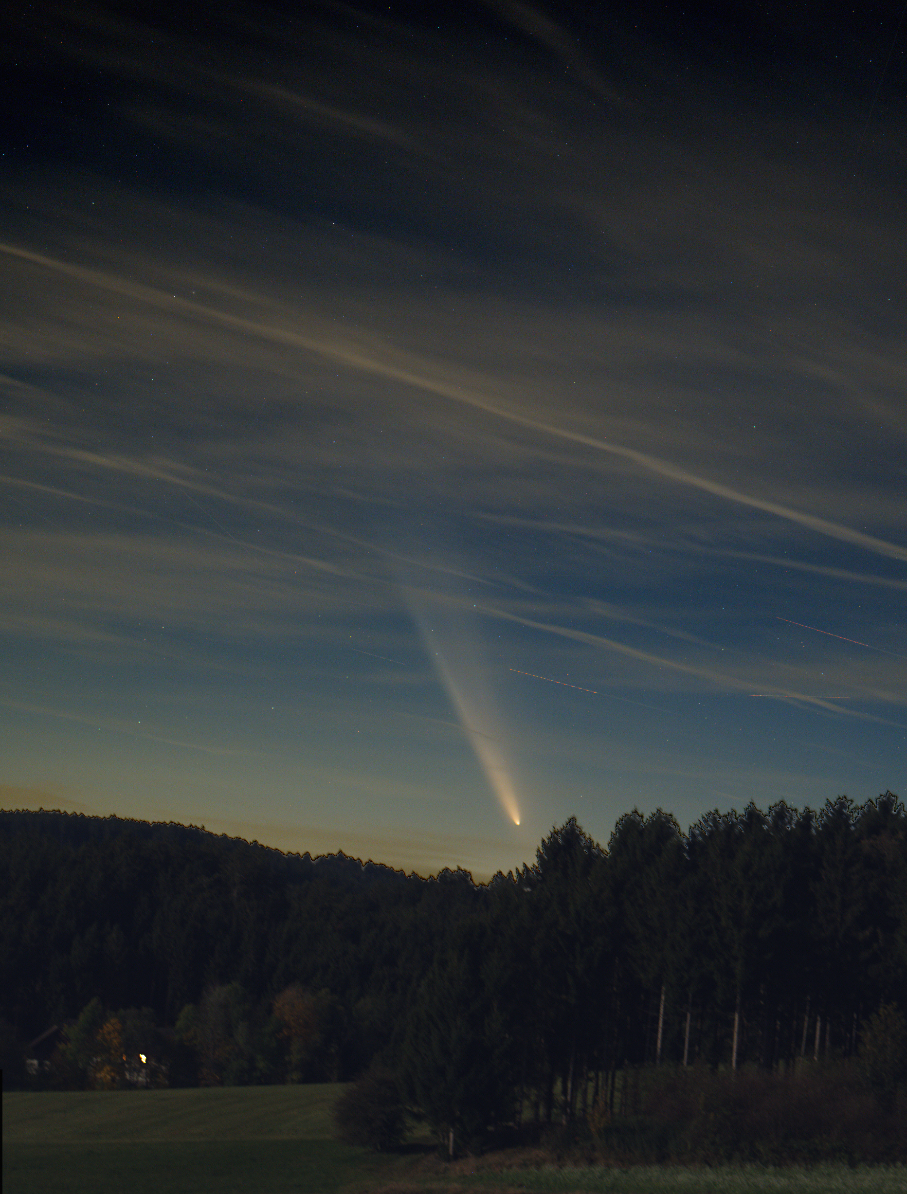

Und noch das Bild vom 30.9. mit dem zersausten Ionenschweif.
Das Komposit wurde mit Leica-Apo-Telyt f-180/4.0 und Canon 200/4.0
sowie QHY600 und Canon 6d mod. auf der Farm Tivoli in Namibia gemacht.
Beide Optiken wurden auf eine G11 gepackt
Michael Jäger, Gerald Rhemann, Dennis Möller
2023A320240930f180-2_2.jpg [ 4.26 MiB | 70443 mal betrachtet ]

Liebe Micha, das letzte Bild mit dem zerzausten Schweif finde ich wirklich eindrucksvoll. Kometenphysik zum Miterleben! Recht vielen Dank.

Wir hatten 4 perfekte Nächte (29.9-2.10). Davor und danach war der Himmel dunstig und die Durchsicht nicht so toll. Aber an den sehr klaren Nächten war der Schweif
erstaunlich hell. Auffallend war dass er 2-3 Grad sehr hell und dahinter gleichmäßig hell über die gesamte Distanz von 15-20 Grad war, das Ende kam ohne fast jeden Übergang.
Aber selbst in den schlechten Nächten (z.B. 4.10) konnte ich den Schweif freisichtig sehen, als der Kopf noch unter dem Horizont war.
Den Ionenschweif konnten wir am 30.9 bis 2.10 nachweisen. Der Sodiumschweif war auf Aufnahmen mit dem 12"/2.8 von Dennis Möller (mit Farkamera) einwandfrei sichtbar.
