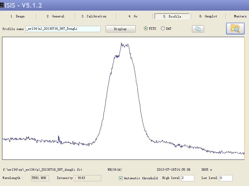

BeitragVerfasst: 17. Juli 2013, 07:36:55 AM
Beiträge: 49
Wohnort: Tianjin, CHINA
Hi friends:
Here are my fresh results of WR134 last night.
Instrument Response is made by Altair at 5411A.
Happy to recieve your comments. :)
Dong
Zet-aql.jpg [ 72.95 KiB | 27969 mal betrachtet ]
Del-sgr.jpg [ 121.69 KiB | 27969 mal betrachtet ]
134-2.jpg [ 128.8 KiB | 27969 mal betrachtet ]
134-1.jpg [ 127.82 KiB | 27969 mal betrachtet ]
altair-IR.jpg [ 108.6 KiB | 27970 mal betrachtet ]

BeitragVerfasst: 17. Juli 2013, 12:51:12 PM
Hello Dong,
Are you sure you are at the right wavelength? Here are my results from 20130712 and 20130715 for comparison
----- Original Message ----- From: Dong Li (fg-spek-convento@vds-astro.de)
Sent: Wednesday, July 17, 2013 6:36 AM
Subject: [fg-spek] Re: Teide 2013 WR campaign
Hi friends:
Happy to recieve your comments. Bild
Dong
