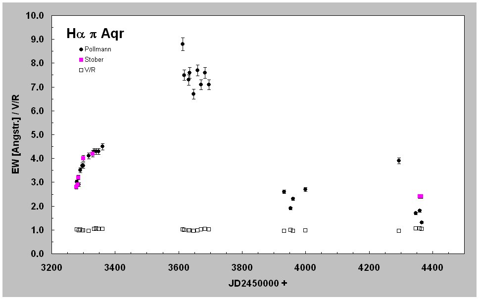

Dear colleagues!
Pi Aqr seems to have had only a short stay in the Be phase (~ 3 years?). The current Halpha EW (see attachment) could mean that it´s on the way back to the B phase.
Any comments?
Ernst Pollmann
pi_Aqr.jpg [ 34.96 KiB | 18689 mal betrachtet ]

Kommentar von Thom Gandet zu pi Aqr-Monitoring:
Hi Ernst,
Thanks for the Pi Aqr and Zeta Tau EW graphs! Very interesting
results. Do you think the observations may allow for a maximum in
EW around JD 2454150? Your "EW curve" looks like some light
curves of Be stars I have seen (like Delta Sco!) - a large maximum
is followed by a decline and then by other "mini-outbursts".
Each "mini-outburst" is weaker than the one before it. They
dampen to very small "flickering". It will be really interestint to
see if the EW do that. Do you know of other Be stars that
do that?
Best regards,
Thom

Kommentar v. Gerrie Peters v. Be-Star-Newsletter (in Be Star Mailingliste):
Dear Ernst,
Very interesting about pi Aqr. I would be interested in seeing
the current H-alpha line profile overplotted against a typical profile
observed around JD 2453650 when the emission was strong.
Gerrie

ich hatte dir aktuell u.a. pi Aqr für dringende Beobachtungen empfohlen.
Ist es dir gelungen ein Spektrum zu gewinnen?
Die gegenwärtigen Halpha-Veränderungen sind besonders drastisch (siehe Anhang)!!!!
Es sieht es nicht so aus, als dass sich die Scheibe neu bildet, es strömt zwar einiges Material ab, kehrt aber vermutlich wieder zur Sternoberfläche zurück.
Ein sehr interessantes Geschehen im Moment!!

anbei ein Spektrum vom 16/10/2007:
EW= -2,0 +- 0,36 Angström.
piAqu20071016_Ha_nr.png [ 32.47 KiB | 18035 mal betrachtet ]
