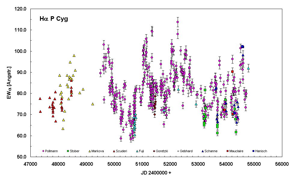

Dear project partners,
our friend Mitsugu Fujii from Japan has taken a very important spectrum of P Cygni.
Very important, because during the last months, observers in Europe due to the very bad weather were not able to take spectra. In the attached plot you can find the current status.
Thank you Mitsugu!!

Hello P Cygni observers,
of P Cygni.
This is an impressive collection of data! Unfortunately, the x-axis is
very compressed. Therefore it is difficult to see, what is happening on
shorter time scales. My first impression is, however, that the error
bars are too optimistic: P Cygni has *very* broad emission line wings.
This means, that the integration range in wavelengths has to be very
large in order to measure a reliable equivalent width.
Therefore, the following is required for a good measurement of the
equivalent width:
1) The wavelength range covered by the spectrograph should be
significantly larger than the wavelength range measured for the
equivalent width. In this case, an estimate of the non-linearity of the
continuum is possible.
2) The continuum should be very flat or vary only linearly with
wavelength. Otherwise you do not know what the continuum is doing
between the integration limits. Because of the wide wings, normalization
requires significant interpolation.
In any case, a good error estimate is very difficult for the Halpha line
of P Cygni. How was the error estimated and did all observer use similar
procedures? In my opinion, a 10% error is already quite good, at least,
when results from different observers are compared.

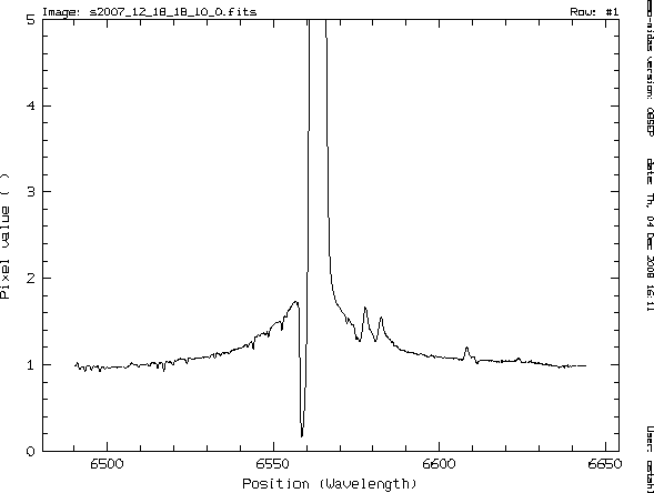

As an example I enclose a spectrum taken by Lothar Schanne. The wings
cover almost the full spectral range. From my spectral atlas, I can
trace the line wings from about 6500 to 6630 A:
http://www.lsw.uni-heidelberg.de/users/ostahl/pcyg/
When you do not know where the continuum is, the error of the equivalent
width is a almost undefined. You can only *assume* that the continuum is
linear.
My recommendation would be to use another, less problematic, spectral line.
Best regards,
Otmar
pcygni.png [ 2.34 KiB | 1618 mal betrachtet ]

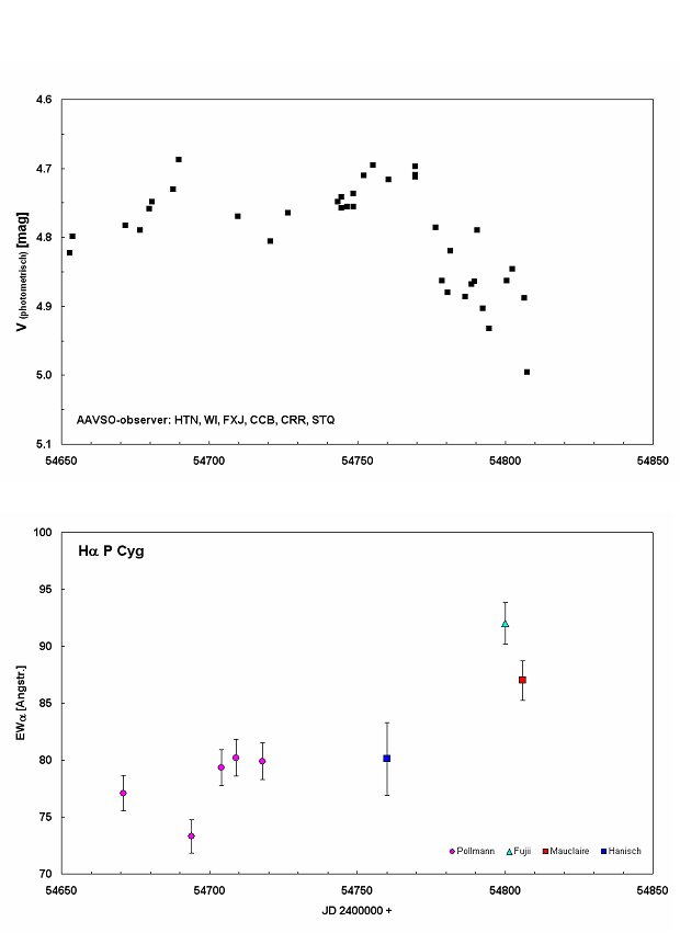

I will try to inform you as regularly as possible about the progress of our common P Cyg project.
Actually there are new measurement both, in Halpha equivalent width and in V.
The attached plot shows the current situation.
My feeling is, that we see first indication of the anti-correlation (found by N. Markova) between this parameters.
Unfortunately the amateurs in Europe have been not able to take more spectra because of the bad climate situation.
Additionally the visibility of star is going soon to the end.
But it seems that we can be optimistic, to find interesting results in the future, if we collect further continuously our data.
Thank you all for your data contribution,
merry christmas and a happy new year,
Ernst
