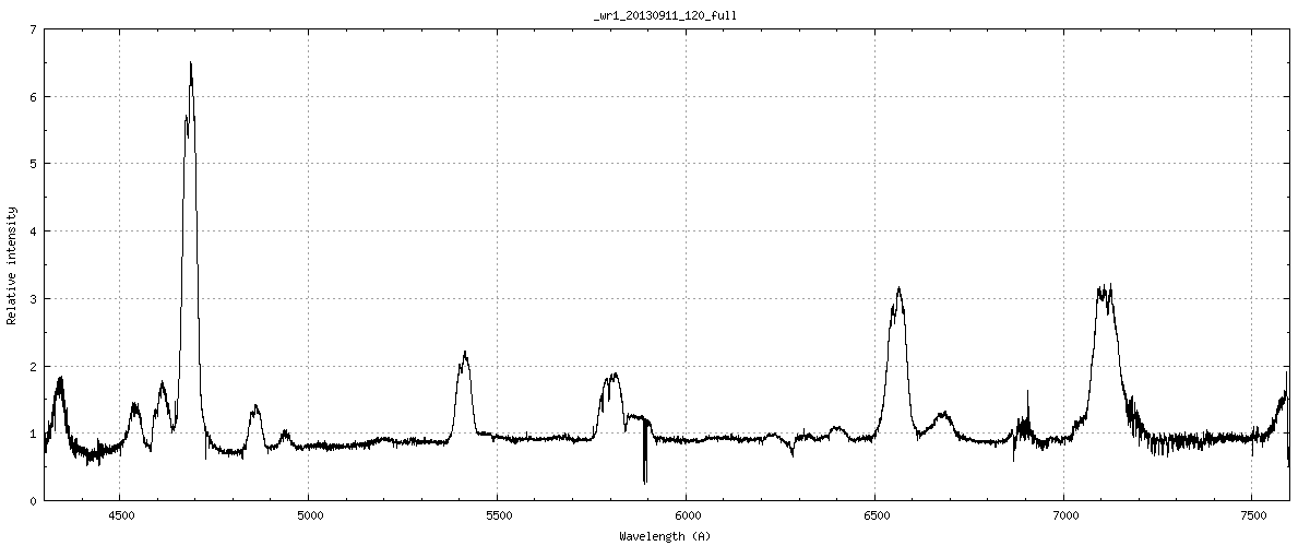

I reduced the last spectra. They look good as always. Here two examples. From WR1 I used only 4 images. Keep going.
Regards, Martin
_wr134a_20130910_901_fullg3.png [ 7.94 KiB | 10165 mal betrachtet ]
_wr1_20130911_120_fullg3.png [ 9.32 KiB | 10165 mal betrachtet ]
