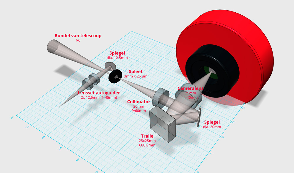

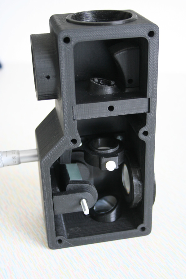

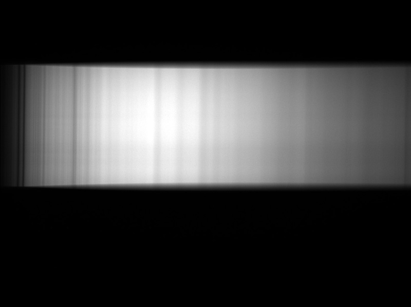

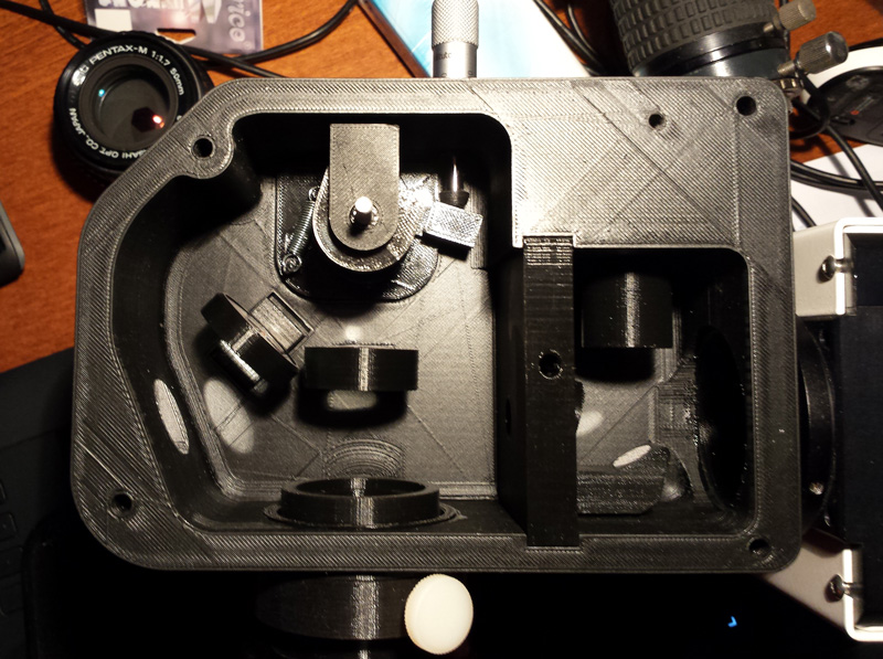

Hello to all,
My name is Paul Gerlach and I'm from the Netherlands.
I've been using a DADOS spectrograph for a couple of years now and wanted to try something new; building a low resolution spectrograph.
Almost the entire instrument is made with a 3D printer except of course for the optical components.
Because I wanted a compact design that could be printed with my 3D printer I've chosen this optical layout. In hindsight probably not the most efficient design.
It sort of works but I can't seem to get a good focus unless I attach a photo lens and restrict the amount of light going into the instrument. I suspect that this is due to internal reflections.
Also, choosing a short focal camera lens make focusing a real pain.
I'm a total beginner when it comes to designing and building a spectrograph. I also have a limited knowledge of optics.
I hope that some of you can help me out a bit. Can this design be salvaged or should I scrap it and start over?
Regards,
Paul Gerlach
opzet-LOWSPEC.jpg [ 188.8 KiB | 33775 mal betrachtet ]
sharpening.jpg [ 181.24 KiB | 33775 mal betrachtet ]
firstlight-opstelling.jpg [ 127.47 KiB | 33775 mal betrachtet ]
spectroscoop-met-optiek.jpg [ 129.08 KiB | 33775 mal betrachtet ]
BeitragVerfasst: 06. Mai 2016, 23:32:18 PM
Hello Paul,
welcome in this forum !
First, my knowledge says, that is the first amateur spectrograph made completely by 3D-printer ! :D :!:
The spectra show sharp lines at the left side and more diffuse lines at the right. Perhaps is the camera not exactly adjusted relative of the optical axes (the sensor have to be perpendicular due the optical axes)? Or the combination of mirror and grating produces a beam running not exactly along the optical axes. Then you have to adjust the mirror a little bit. The collimated beam from grating through the camera lens onto the sensor should symmetrical along the optical axes.
Excuse my bad english.

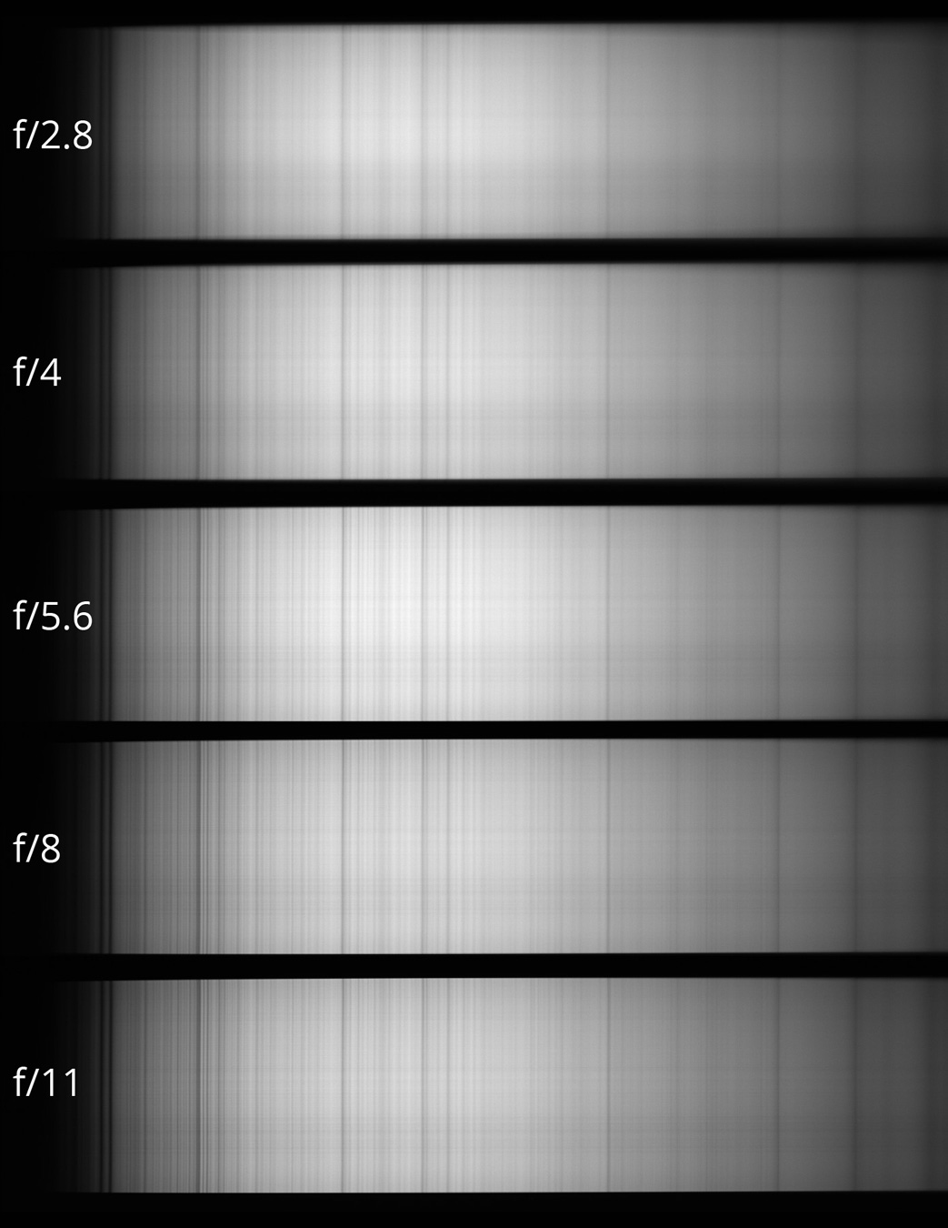

Hello Lothar,

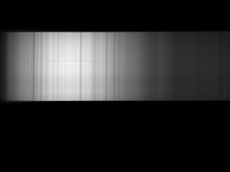

As far as I know, I'm not the first. To my knowledge that honour goes to a gentleman (Scott) from Arizona who posted a 3d printed design on Cloudy Nights.
Thank you for your suggestion. However, I don't think that's the issue here. It would not explain why I get sharper lines over the whole spectral range when I constrict the amount of light going into the instrument. If it would be a misalignment of the camera / camera lens on the optical axis I would expect that line on one side of the spectrum would still be out of focus. Instead the lines get increasingly sharper if less and less light if led into the spectrograph (see attached examples).
That's why I think this problem has more to do with stray light or internal reflections of the optical components. Or am I barking up the wrong tree here?
Please feel free to respond in German. I can read it and understand it pretty well but writing and speaking is a whole other thing :wink: .
Best regards,
Paul

BeitragVerfasst: 07. Mai 2016, 14:11:07 PM
Hi, auch glaube nicht, dass das was mit Streulicht zu tun hat, zumal das Gerät innen ganz schwarz ist.
Tolle Sache sowas mit einem 3D Drucker zu machen!
Kompliment!
Möglicherweise haben die Linsen einen zu großen Farblängsfehler.? Sind das Achromaten?
herzlicher Gruss

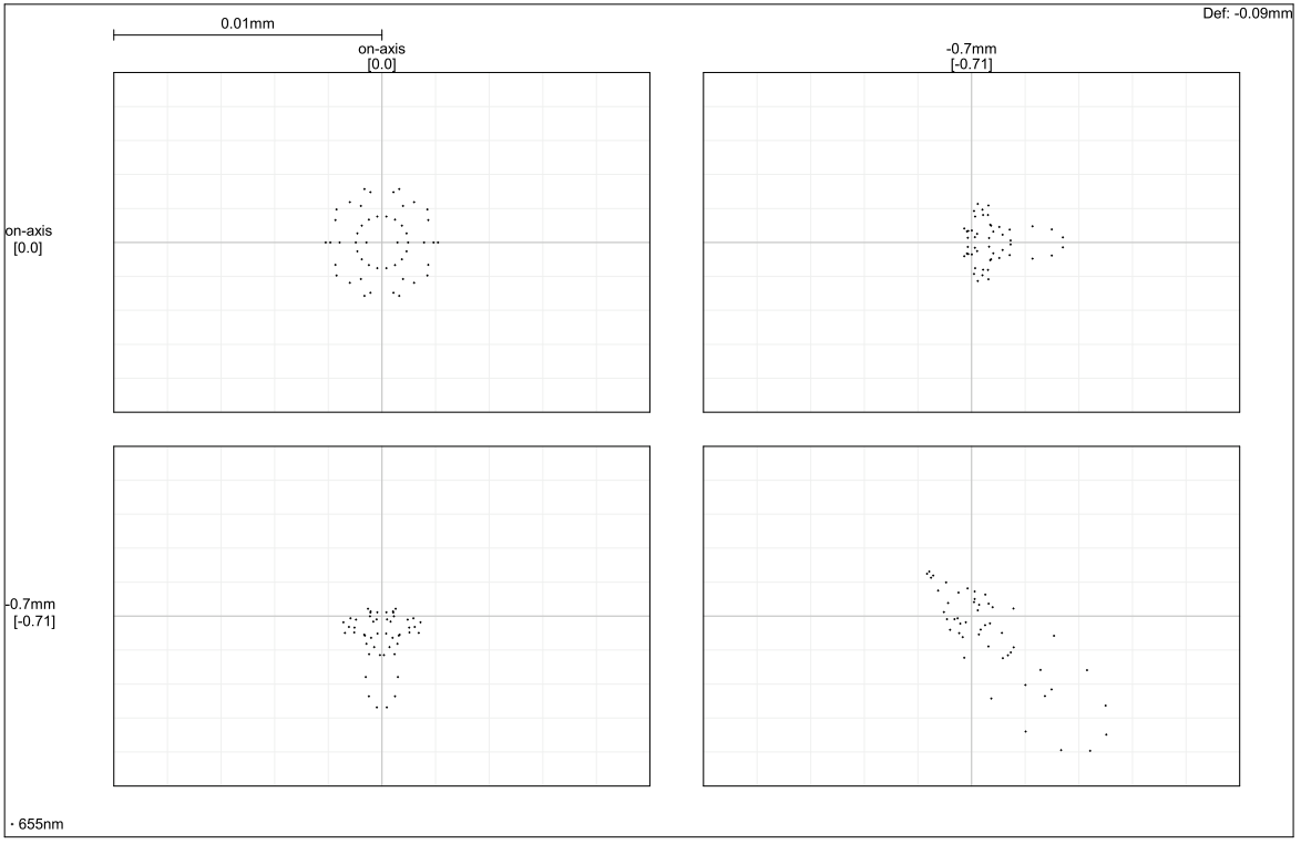

Here the numbers in SIMSPEC.
Maybe that this range is pushing it a bit...
Cheers,
Paul

BeitragVerfasst: 08. Mai 2016, 19:39:56 PM
Hello Lothar,
Hallo Paul,

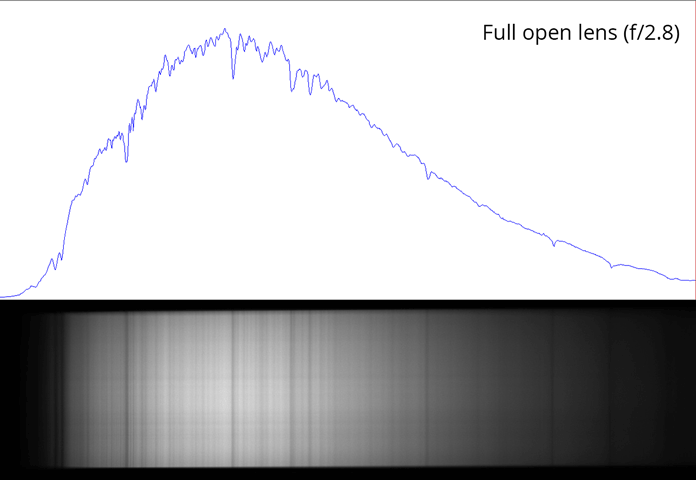

es sind mindestens 2 sich überlagernde Effekte zu sehen, die mir schon erklärbar scheinen:
1. Das Abblenden von 2.8 auf bis 11 ergibt natürlich eine Verbesserung der Bildschärfe, wegen des Öffnungsfehlers der Kameralinse. Das Arbeiten mit großen Blenden (niedriges Öffnungsverhältnis) führt immer zu unschärferen Abbildungen.
2. Trotz des fortschreitenden Abblendens bleiben aber auf der rechten Seite des Spektrums die Linien bei allen Blendenstufen unschärfer wie links. Das kann bedingt sein durch Fehler im alignment oder aber durch den Farbfehler der Kameralinse, wenn du die Scharfeinstellung auf die linken Spektrallinien eingestellt hast. Versuch doch mal auf die mittleren Linien scharf zu stellen und mach dann die Abblendreihe noch mal.

BeitragVerfasst: 09. Mai 2016, 10:28:34 AM
Hi Paul,
welcome!
The increase of sharpness comes definitely from spherical aberration. F/2.2 is not a good idea, to be honest.
I see three possibilities:
1. Reduce the total angle at the grating
2. Reduce collimator focal length
3. Increase focal length of camera lens
Best regards,
Daniel

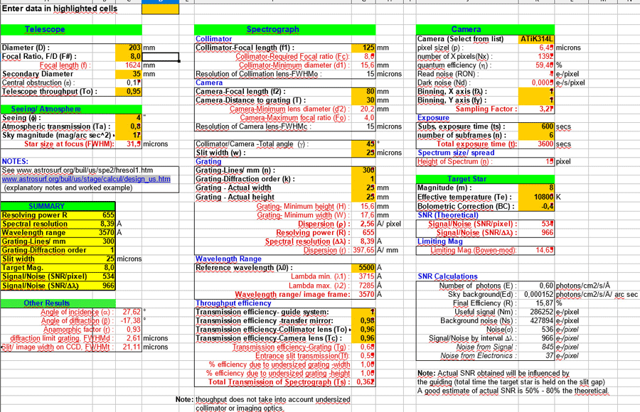

BeitragVerfasst: 13. Mai 2016, 20:53:51 PM
Registriert: 06. Mai 2016, 20:38:32 PM
Beiträge: 40
Wohnort: Utrecht, The Netherlands

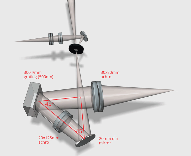

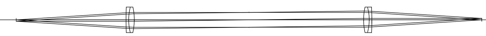

I've come up with an altered design. Optimised for an f/8 telescope.
Due to the longer focal length of the collimator and in order to keep the spectrograph compact I've placed the collimator after the mirror. Also I'm planning to use an 80mm achromat as a camera lens.
Thereby hoping to reduce the spherical aberration that my first design was plagued by.
What do you think?
Best regards,
Paul
LOWSPEC-2-setup.jpg [ 57.94 KiB | 33507 mal betrachtet ]
Simspec-lowspec-2.gif [ 96.12 KiB | 33507 mal betrachtet ]
BeitragVerfasst: 13. Mai 2016, 21:44:03 PM
Beiträge: 244
Paul,
That looks promising. Ideally a 30mm Sq. grating.....
You only need a single doublet for the guide optics - cheaper and can give acceptable guide images.
Ken

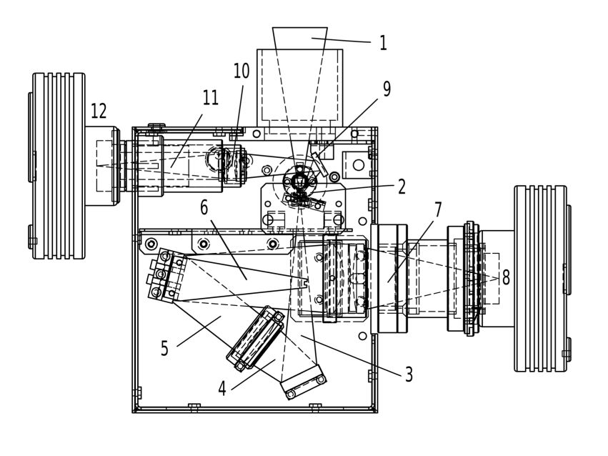

BeitragVerfasst: 13. Mai 2016, 21:48:52 PM
Beiträge: 265
Wohnort: Maienfeld, Schweiz
Hallo Paul,
it looks better now. Is it a coincidence that it looks very similar to the LISA by Shelyak? http://www.shelyak.com/rubrique.php?id_rubrique=12
LISA crosssection2.jpg [ 71.12 KiB | 33500 mal betrachtet ]
The main difference is that the LISA has a faster f-ratio, but also a better corrected camera lens. Yours is probably lighter and should work well (without calculating the optics in detail).
Regards, Martin
BeitragVerfasst: 13. Mai 2016, 22:05:53 PM
Beiträge: 40
Ken, 30x30mm just to be on the safe side? SimSpec shows that the minimum width is approx. 18mm.
Martin, it indeed looks like the LISA design but I got there via 'evolutionary' design :wink:
I simply wanted to keep the 45 degree arrangement of the first design but had to shift the collimator so that the dimensions of the housing can still be printed on my 3D printer.
Regards, Paul

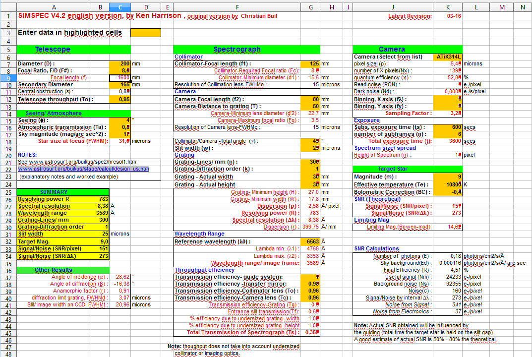

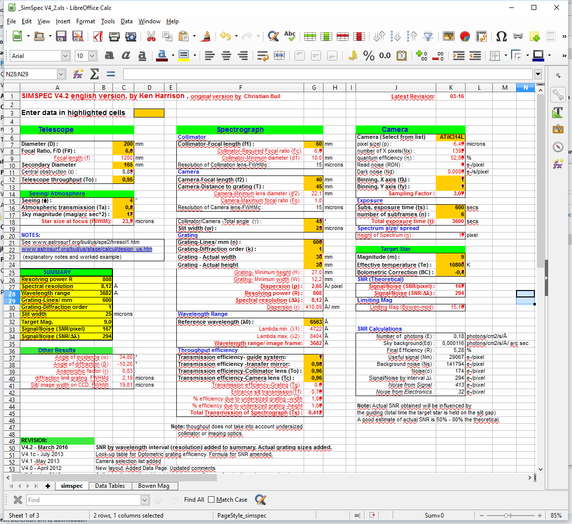

BeitragVerfasst: 15. Mai 2016, 16:24:55 PM
Beiträge: 244
Paul,
There seems to be an error in your spreadsheet....
The height of the grating should show (Cell G25) 15.6mm This would then mean a 25 mm Sq. grating would be good.

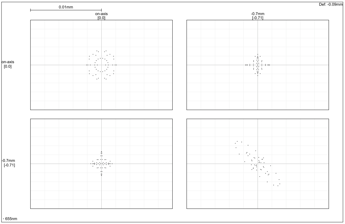

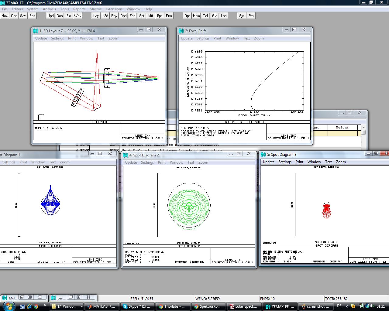

BeitragVerfasst: 15. Mai 2016, 17:40:40 PM
Beiträge: 384
Wohnort: Umina Beach

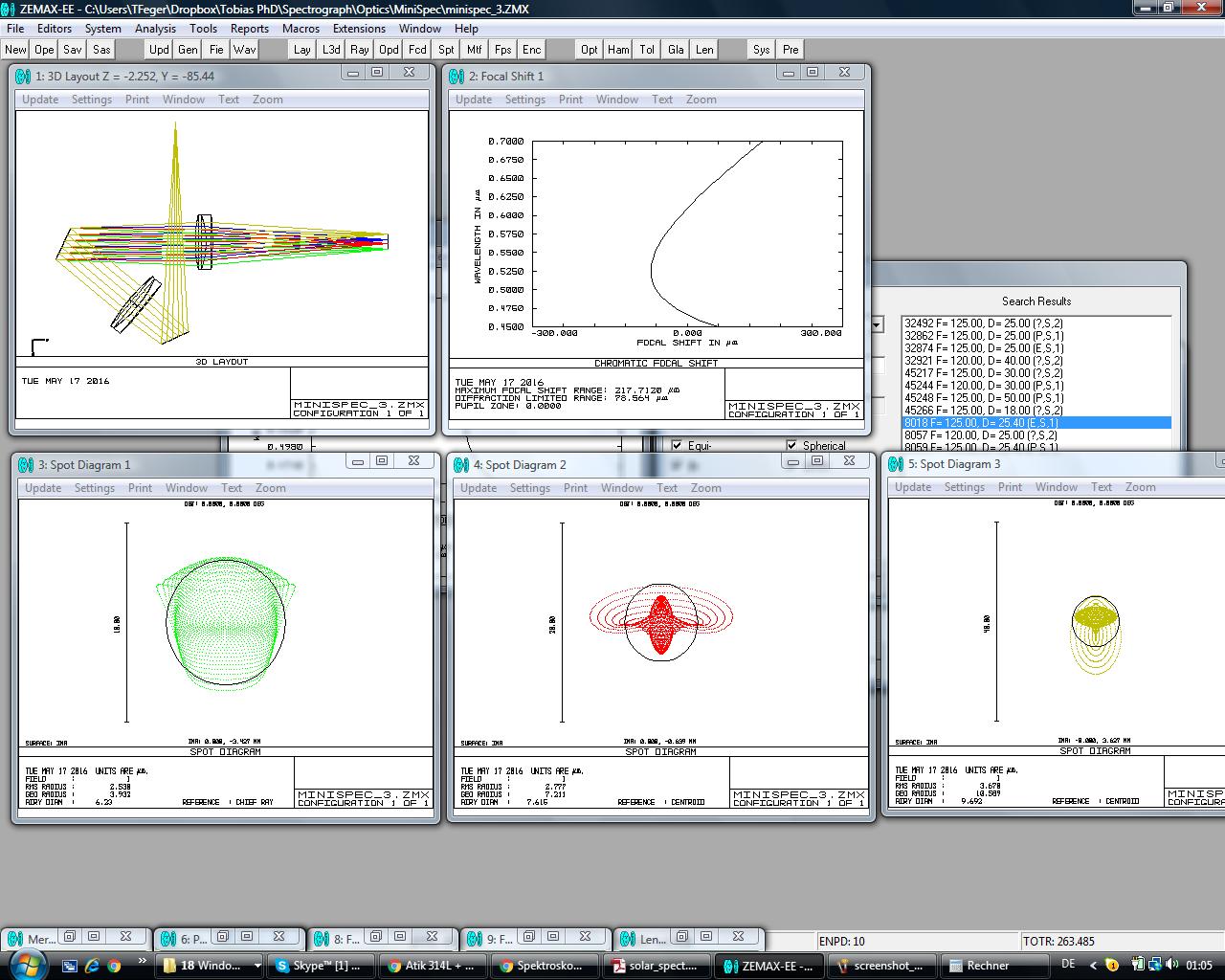

Paul,
if you provide me with the lens details (e.g. vendor & stock number) I can set up a better model. Once we found the correct parameters I can export the model as a STEP or IGES file which hopefully can be read by your software. I used lenses from Thorlabs and Edmund which had the corresponding focal lengths. I put all together in a rush but could certainly spend some time improving the image quality (e.g. tilting the CCD can improve the spot quality a lot).
What wavelength range are you after? What are the desired angles and distances between the optics?
Btw. the minimum size of the grating is 15.8 mm.
Tobias
screenshot_1.jpg [ 190.16 KiB | 33344 mal betrachtet ]
BeitragVerfasst: 15. Mai 2016, 17:54:17 PM
Beiträge: 244
Tobias,
Based on the f8 input and a 125mm collimator I get 15.6mm for the exit beam to the grating, this then gives a design width of 17.6mm at the alpha angle of 27.62 degrees....
Where did we go wrong??
Ken
BeitragVerfasst: 15. Mai 2016, 18:04:59 PM
Beiträge: 384
Hi Ken,
I got 15.6 mm for the collimated beam. Not sure what I screwed up with the angles, but I will have a look. Bit late here in Australia ;)
Tobias
BeitragVerfasst: 15. Mai 2016, 21:32:12 PM
Beiträge: 40
Tobias,
I appreciate that you are taking the time to make this analysis. Looks like an impressive piece of software. A focal shift of 0.2mm looks like a lot to me. But than again I don't have much knowledge of optics.
The wavelength range I'm after is the optical spectrum 4000 – 7000 Å. Preferably a bit more; 3500 Å coverage (see my SimSpec screen). I'm not sure if that's pushing it with a simple achromatic lens?
But maybe I should just take some focal shift into account. After all, I'm not after the perfect design but rather a cost effective solution. I'm striving to design a spectrograph that is somewhere between the ALPY and LISA but at a fraction of the cost.
Here are the optical components:
Mirror: AX27404from Anchor Optics.
Collimator: AX27276from Anchor Optics (a division of Edmund Optics).
Grating: GR25-0305 form Thorlabs.
Camera lens: AC300-080-A from Thorlabs.
If there are better alternatives please let me know.
To design the parts for the 3D printer I use 123D Design from Autodesk. It can read STEP files.
@Ken: Thanks for the new SimSpec version. I noticed the strange value and ignored it when making the 3d drawing figuring the height should be the same as the diameter of the collimator beam.

BeitragVerfasst: 16. Mai 2016, 08:58:23 AM
Beiträge: 384
Hi Paul,
thanks for the specs. Can we actually play a little bit with the collimator/camera focal lengths? I will try out some solutions over the week.
BeitragVerfasst: 16. Mai 2016, 09:32:21 AM

As far as I'm concerned, please play with collimator/camera specs. The only thing I can do is tinker with SimSpec. What Tobias can do with Zemax is fare better! You can actually see if this thing is going to work or not.
It would be fantastic if this could result in some sort of open source spectrograph! I've noticed that a growing number of amateurs in The Netherlands and Belgium are interested in spectroscopy but are put off by the pricetag of a commercial spectrograph. Myself included. Of course they are all fantastic instruments and worth every dollar or Euro. But it's still a big investment!
Paul

Hi Paul,
I just want to mention that there is a free version of WinLens3D, which is capable of designing classical (and echelle for some extend) spectrographs. You can find it here:
http://www.winlens.de/index.php?id=23
cheers,
Daniel
BeitragVerfasst: 16. Mai 2016, 11:59:32 AM
Hi Paul, the spectro community grows, indeed. In principle, a scientifically useable high-resolution spectrograph can be designed for clearly less than 1000 Euros. But it needs some tinkering skills and the willing to learn some basic opto-mechanics, as you see for your fantastique approach (yes, I am also impressed about you 3D printer idea). But after circumnavigating these hurdles one can do astronomy (and real science) from urban environments. Our most spectacular fellow is Dong Li from Tianjin (12 Mio. people) and a 5 arcsec seeing (gosh!). There are always single pioneers who bring the spectroscopy on the radar screen in different countries. This was the case for Germany, France, Danmark, England, Switzerland, Australia and Brazil. You could fill this role in Holland. So, go ahead! Our forum will deliver respective support.
Cherio, Thomas
BeitragVerfasst: 16. Mai 2016, 17:06:47 PM
Beiträge: 384
Hi Paul,
still bit confused about the angles but here is the latest version with 2 achromats from Edmund (45217 and 45213). The spots are quite small when focused somewhere around 610nm. The wavelength range is now extended from 450 to 700nm with footprint of 7 mm on the Atik chip. There is no CCD tilt assumed here.
left = 450nm , middle = 550nm , right = 700nm
Tobias
screenshot_2.jpg [ 206.89 KiB | 33207 mal betrachtet ]

Hi Tobias,
Is this drawing helpful?
Also, what's the focal ratio of the incoming beam?
If the incoming beam would be f/6 and the colli a 25mm fl=125mm and camera a 30mm fl=80mm would that be possible?
I get the impression that it is not possible to image the whole spectrum without some amount of defocus in one part of the spectrum.
Simspec-lowspec-2-angles.gif [ 83.73 KiB | 33189 mal betrachtet ]
Paul

Dear Opticians,
you should try to minimize the 45° angle at the grating. If you want to keep the bean-crossing configuration, try to place the collimator before the dispersed beam such that your are not limited in beam length between folding mirror and grating.
Furthermore, the distance between grating and lenses should equal the focal length of the lenses to keep telecentricity.
best regards,
Daniel

Hi Daniel,
Do you mean returning back to my original design?
Problem with that design is that the collimator is 'in the line of fire' of the second order.
Also this would make the whole thing rather large and then the crossing beam configuration would make no sense any more.
Why should the camera lens be at and 80mm distance? I was always under the impression that this lens should be as close as possible to the grating? If this is an important aspect, why do I see other designs that do not honour this rule (e.g. DADOS)?
Best regards,
Paul
BeitragVerfasst: 16. Mai 2016, 20:57:33 PM
Hi Paul,
well it is a question of symmetry. The grating should take the role of the aperture which gives symmetry to the system if placed in the correct distance to the lenses. This will suppress off-axis aberrations, in particular coma.
I've attached some figures with spot diagrams for a simple set-up of two lenses. You can see that the off-axis spots for the telecentric set-up are symmetric and suffer less from coma. It is not of major influence for imaging systems with small objects (slit) but could become important for larger field sizes (spectrum image).
cheers,
Daniel
telecentric_spot.png [ 34.21 KiB | 33161 mal betrachtet ]
telecentric_layout.png [ 21.94 KiB | 33161 mal betrachtet ]
nontelecentric_spot.png [ 40.21 KiB | 33161 mal betrachtet ]
BeitragVerfasst: 17. Mai 2016, 01:54:34 AM
Beiträge: 384
Hi Daniel,
Best regards,
Paul
Hi guys,
Daniel is right, telecentric is most favorable but often not achievable due to design constraints.
To clarify the design above uses a 125/30 mm collimator and a 85/25 mm camera lens. The camera lens is currently at a distance of 60mm and the input focal ratio is f/8.
Tobias

OK, I've been tinkering with a Pentax 50mm lens as a camera lens with my first design.
The resulting spectra without any optics in front of the slit are somewhat better but the overall problem remain. It's impossible to get a good focus across the whole spectral range (in this case about 3000 Å). Again, sharp spectra when setting the input beam at f/11 or higher.
The set-up now has become heavy and ugly (from a design point) with this Pentax-adapter-camera arrangement hanging on one side. Also the camera lens was never designed to be used in this way. There is sideways play in the focusing mechanism.
I've placed some pictures with a laser beam. The slit has been removed. There's obviously a problem with reflections of the collimator. There is even a second spot on the mirror.
I think it's time to scrap this design in favour of the second. What do you think?
I don't like using camera lenses like the 50mm Pentax. They make the whole design cumbersome and ugly.
Paul

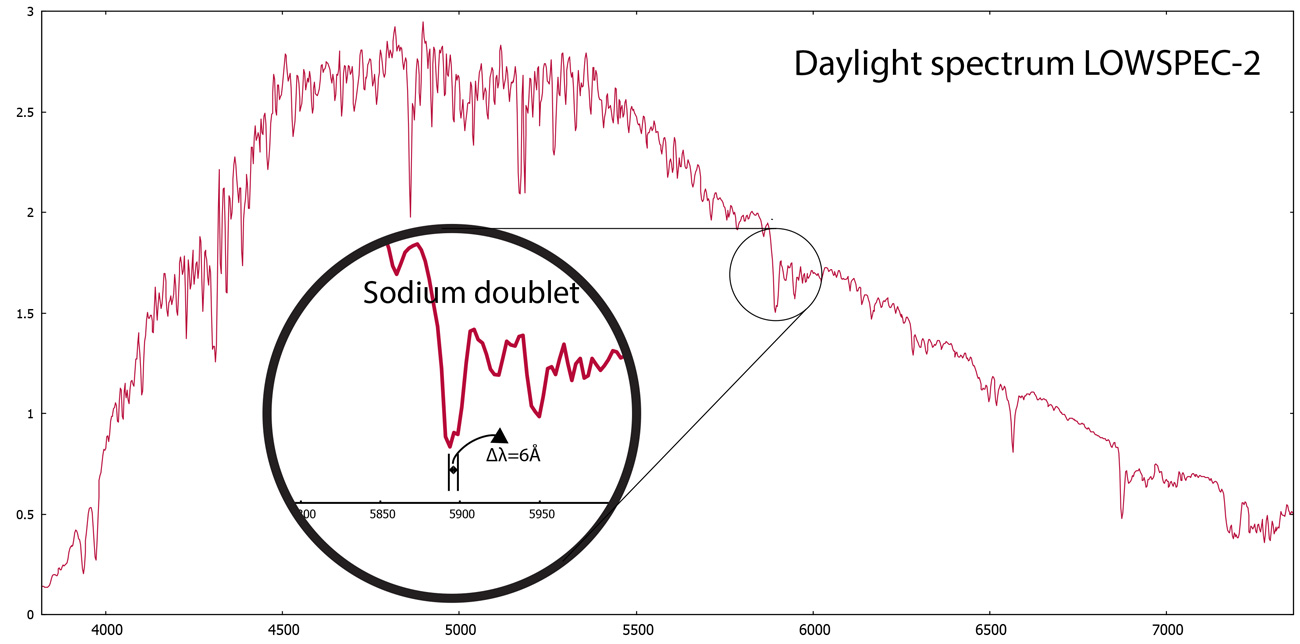

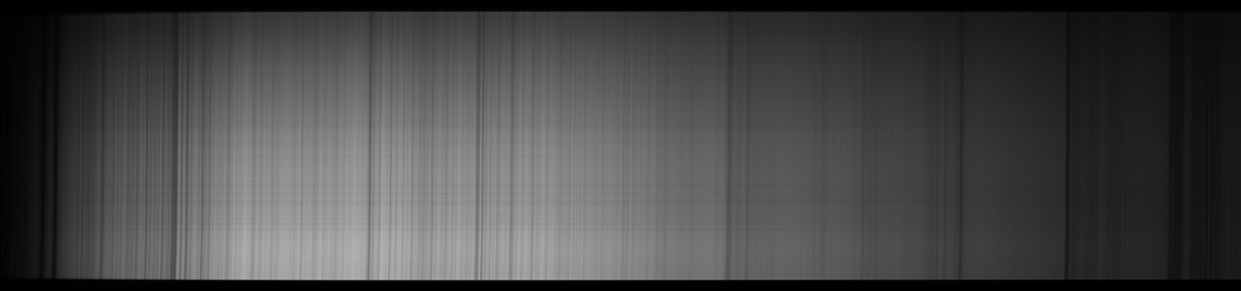

It’s been a while since my last post here, but I’ve finally had some time to realise this new design.
At first I had the same difficulties with focusing the spectrum across the whole wavelength range as with my first design. But even then the image was much better.
In order to increase the focus Tobias suggested to tilt the camera. This is not easy to realise so I came up with the idea to tilt the camera lens slightly instead. The result is a much flatter focal plane.
I’ve yet to make some real stellar spectra, but I hope this will be possible in the days to come.
I do have my concerns about guiding. The slit image shows a rather rough surface and I’m afraid that this will cause light to scatter.
As with my first attempt this instrument is also 3d printed.
Cheers,
Paul
setup.jpg [ 140.58 KiB | 31887 mal betrachtet ]
inside.jpg [ 190.57 KiB | 31887 mal betrachtet ]
design.jpg [ 113.43 KiB | 31887 mal betrachtet ]
LOWSPEC2-daylight-spectrum.jpg [ 117.04 KiB | 31887 mal betrachtet ]
LOWSPEC2-daylight.jpg [ 42.84 KiB | 31887 mal betrachtet ]

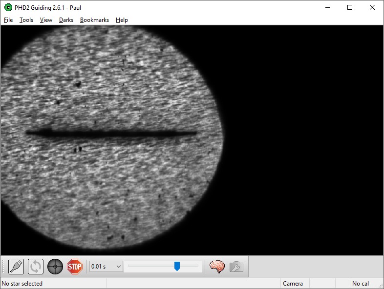

Here the SimSpec data sheet and the slit image seen by the autoguide camera.
Simpec-data.gif [ 185.77 KiB | 31887 mal betrachtet ]
slit_image.jpg [ 85.72 KiB | 31887 mal betrachtet ]
BeitragVerfasst: 29. September 2016, 18:21:34 PM
Hi Paul,
great work !!
Hm... I've looked through the posts but did not find information about the slit you are using.
There are some suppliers of high quality slits on glass:
http://pyser-sgi.com/graticules/apertur ... s-on-glass
https://lenoxlaser.com/shop/optical-ape ... ical-slit/
I've also used stainless steel slits (e.g. from Edmund, Thorlabs etc...) and polished them a little. It's far from perfect, but works reasonable.
kind wishes,
Daniel
BeitragVerfasst: 29. September 2016, 18:48:04 PM
Beiträge: 40
Hi Daniel,
It's a stainless steel slit (25 micron) from LenoxLaser.
The first one they send had a defect (extra hole next to the slit :( ) but was much more refective than the second one they send.
So there seems to be a big variation in surface quality. so I will not go down that path anymore.
I'm looking into the possibility of a chrome-on-glass slit (thanks for the links) but they are way more expensive than the air slit form LenoxLaser.
Cheers,
Paul
