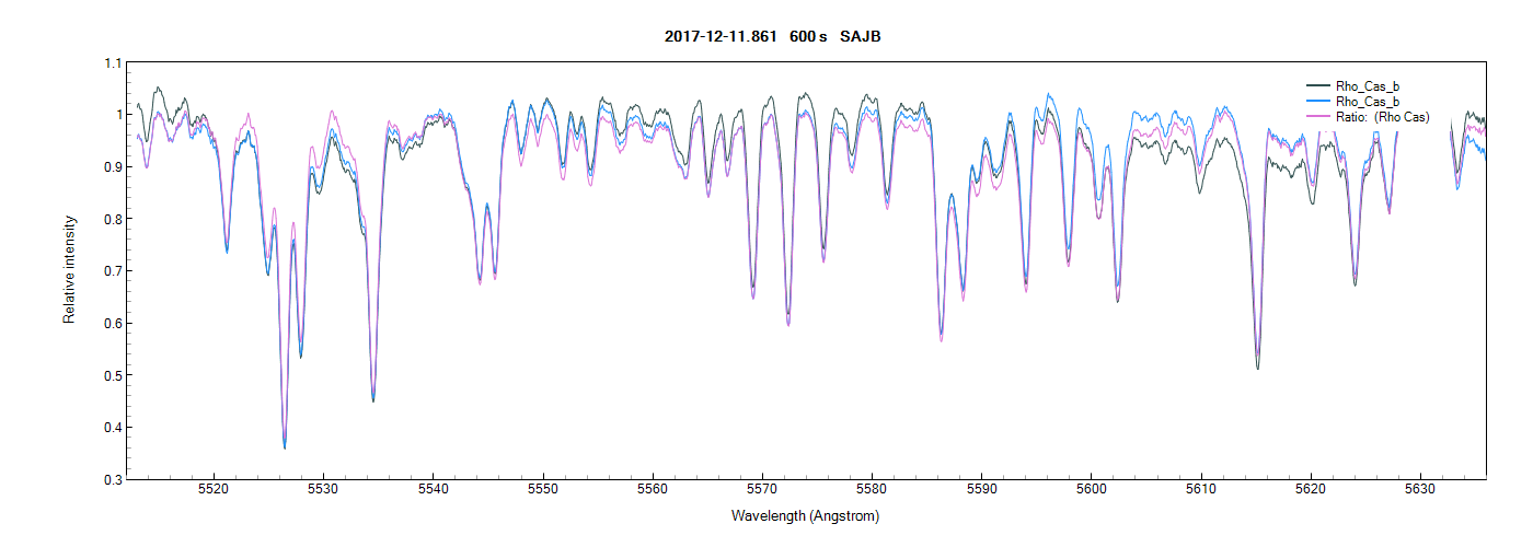

Hi Christian,
I attach a comparison of the two rectified spectra you produced and one I had done in SPLAT-VO. They differ to a degree but it is impossible to say which is best.
I would be pleased if you can tell me all the parameters you had set in "IRAF continuum" so I can try to replicate your results.
In the end I think consistency is important to ensure good EW measurements.
Once I have the continuum parameters from you I will process all my existing spectra to test how robust it is compared to my splat proceedure.
Regards Andrew

Hi Andrew,
for n1 I took the default values ( function = spline3 !), for n2 I set order = 2 and pressed the f-key to trigger a new approximation.

Sorry in order from the top n1 ,n2 and third in the list mine (Ratio: ...)

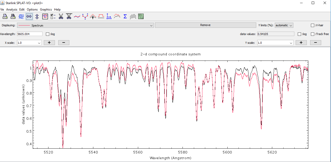

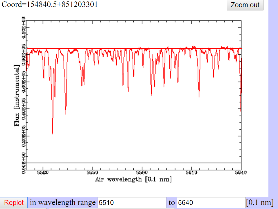

I looked at the ELODIE archive and plotted the region we have been looking at rectifying.
Rho Cas Elodie .png [ 60.96 KiB | 2562 mal betrachtet ]
Then using this as a guide I used the I used the SPLAT interpolation tool to generate a new rectification (black) and compared it with your n1 (red).
I used a set of points which I estimated from the ELODIE to be the continuum and then the hermite curve type to interpolate a continuum.
As expected this gives a similar result to the ELODIE spectrum and has a flatter ceiing than our previous attempts.
Rho Cas n1 SPLAT.png [ 49.01 KiB | 2562 mal betrachtet ]
Regards Andrew
