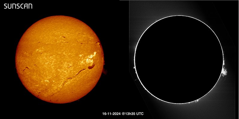

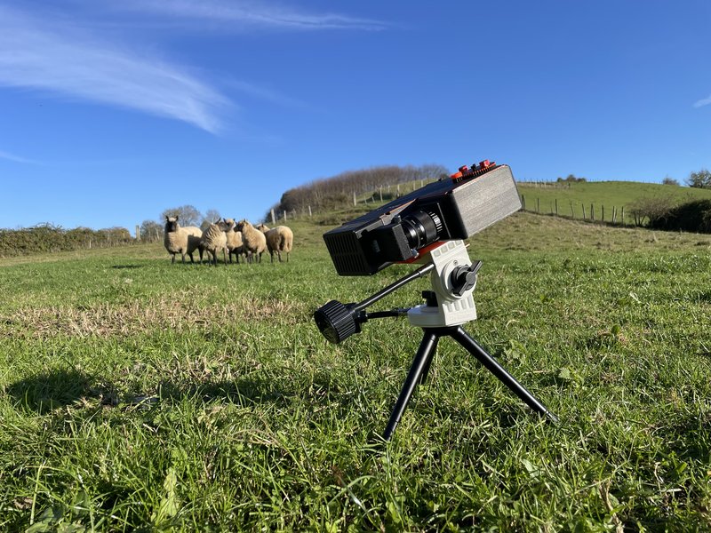

just tested the SUNSCAN on the move.
This one is just placed on the ground and in less than 3 minutes we get this type of image.
So I could have optimized the focus, because here the SUNSCAN is just out of the backpack.

Sunscan completed in 5 minutes (including installation and automatic processing).
all these images were produced automatically from a single scan (no manual processing)
