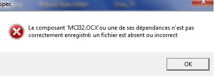

gibt es Besonderheiten bei der Installation von Vspec unter Win7 ?
Beim Versuch zu starten kommt diese Meldung.
LG
Siegfried

Hallo Siegfried
Das Problem ist seit Mai bekannt. Die Fehlermeldung kommt, wenn die OCX-Datei nicht
richtig registriert werden konnte. Die 3? möglichen Lösung stehen unten.
CS
Wolfgang

THIS was the golden clue indeed! The secret was to run cmd.exe as administrator
when registering the ocx. So I did this:
* Launch "cmd.exe" in Windows 7, but don't just hit ENTER but CTRL-SHIFT-ENTER.
This will launch the process as the administrator... which makes all the difference.
* In the new console window, register MCI32.ocx as follows. Path might differ on
your system:
regsvr32 "C:\Program Files (x86)\Visual Spec\MCI32.OCX"
* Then try to start Visual Spec. Mine came up with another complaint about TABCTL32.OCX,
so I registered that as well:
regsvr32 "C:\Program Files (x86)\Visual Spec\TABCTL32.OCX"
Now my Visual Spec starts without complaints and I am ready to try it out with my test
pictures of street lights from yesterday.
Thanks to everybody who engaged in this thread!
André :)

Hello Siegfried
LG
Siegfried
It has happened before. Here is the solution posted on spectro_l (In English I am afraid)
----- Original Message -----
From: valerie.desnoux
To: spectro-l@yahoogroups.com
Sent: Tuesday, May 10, 2011 7:22 PM
Regarding this file, somebedy also mentionned that to me in private. The person succeeded in registering manually the MCI32.ocx component.
"I solved my problem. I put MCI32.OCX in C:\Windows\SysWOW64 and registered it .... but I had to run cmd.exe as the administrator for it to register."
I guees he used regsvr32.exe - Dale, let me know offline if you need help on this task.
Did you run the installation as admin ?
Valerie

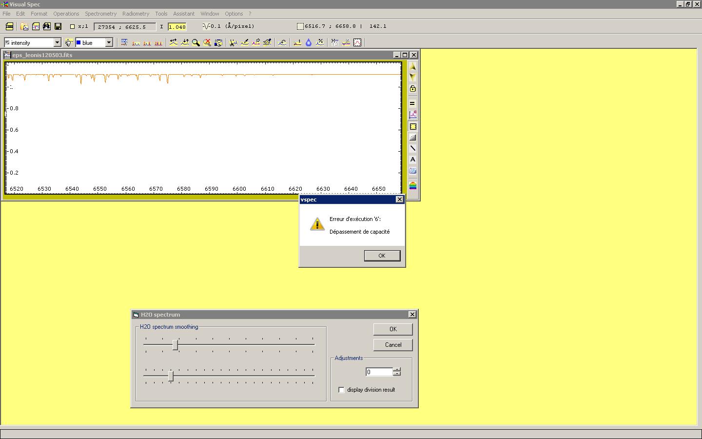

BeitragVerfasst: 09. Mai 2012, 18:41:48 PM
jetzt wollte ich, solange ich nichts Anderes habe mit Vspec was mit den Wasserlinien machen....Ergebnis...stürtzt andauiernd ab.......keine Ahnung, was ichd a machen könnte :(
wenn ich da auf "ok" drücke, dann verschwindet das gesamte Programm
Sehr sonderbar! Wer weiß was dazu bitte?

BeitragVerfasst: 09. Mai 2012, 20:20:00 PM
das ist leider nicht die einzige Stelle, bei der Vspec in die Knie geht. Dies geschieht regelmäßig dann wenn man die Spektrallinientabelle geüffnet hat. Das Programm ist sehr unstabil und hat mich so oft zur Verzweiflung gebracht, daß ich es nur noch benutze, wenn es gar nicht mehr anders geht.
BeitragVerfasst: 09. Mai 2012, 21:23:36 PM

BeitragVerfasst: 21. August 2014, 21:23:01 PM
Beiträge: 639
Wohnort: Schulberg
hatte wieder das Problem mit Vspec und Win7 nach einer Neuinstallation.
Für den Fall, wenn es nicht gleich geht!
Wie es auf der Seite von astrosurf steht vorgehen.
http://www.astrosurf.com/vdesnoux/download1.html
Programm als Administrator installieren, danach das Icon mit rechter Maus anklicken und "als Administrator ausführen".
Das war's.
Siegfried
